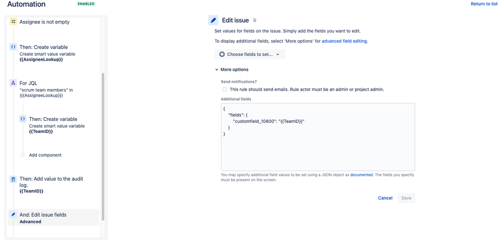

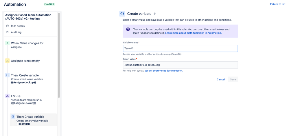

I am trying to create a variable inside of a branched JQL lookup and then use that variable outside of the branch.

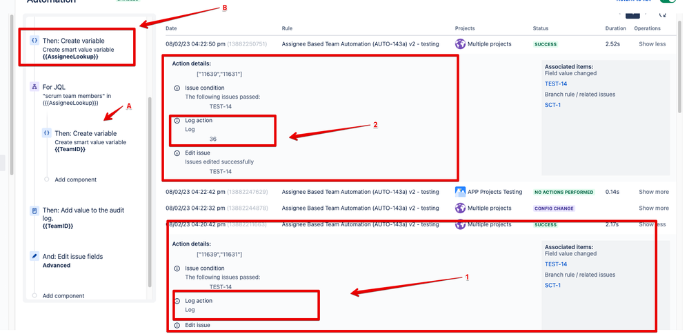

Referring to my below screen shots, I was trying to access Variable A in the "Advanced Edit" at the bottom of the automation rule (which was located outside of the branched rule.
You can see in box #1, logging the action produced no result.
However, when I added Variable B (at the top) before the branched rule, it then changed something which then allowed me to access variable A outside of the automation rule (refer to box 2) which shows the log action.
Below are screen shots of the entire automation rule if anyone wants to see what I am doing. The custom field 10800 is the Teams field that comes from Advanced Roadmaps, and has limited functionality inside of the automation tool, so I must manually manipulate it.

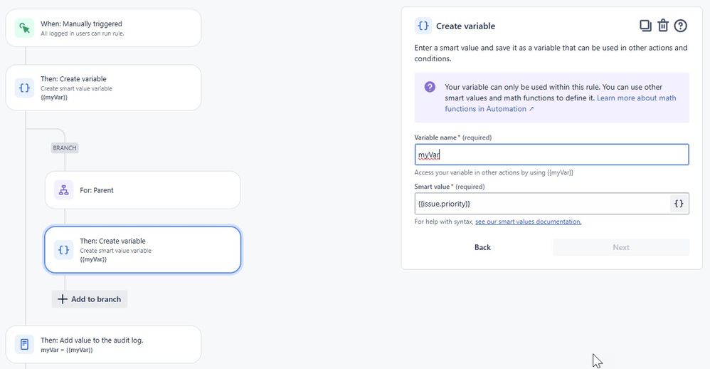

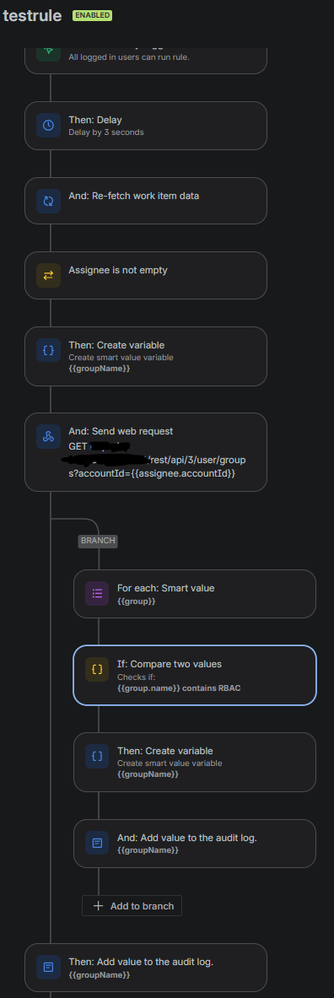

I know this is an old question, but I think I have the answer. Any variable created within an IF Branch or a FOR Branch will not be in scope outside of the branch. However, if you create the variable at the very beginning and give it a default value, you can then give it a new value within your branches, and it will be in scope anywhere in the automation.
When I run the automation and check the audit log, the value of myVar is the value set in the branch.

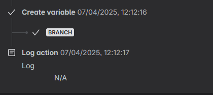

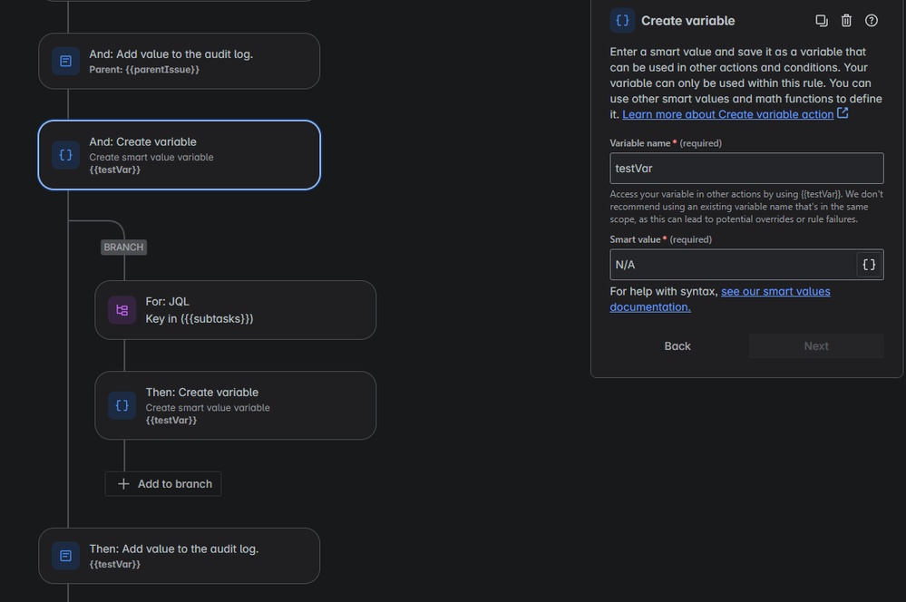

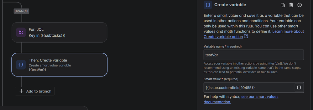

Inside the branch, the value is set to this:
After the branch, in my log I still get this value:
So the value of the variable does not change :(
Your help would be highly appreciated, this is blocking 2 of my important developments.
Thanks in advance!
Bentley, Andrea
July 7, 2025
@Duzmath Lajos your Audit Log shows that your For JQL branch is not executing - that's why the variable value doesn't change.
