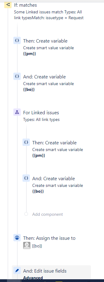

I am trying to use automation when an issue is created, to set the assignee and edit another user picker field with values from 2 user picker fields in a linked issue.
I am creating 2 variables, setting the values to them in a linked issue branch, then coming back to the main line to assign and edit the created issue.
The assigning part works fine. But I can't get the edit of the other field working. The error I'm getting is invalid JSON.
I've tried a few different ways (the variable is called pm):

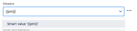

Agree with Gareth - I believe you should be able to use {{pm.accountId}} in the Basic Edit function without having to deal with JSON at all:
The UI is a bit fiddly though:
You have to start typing {{ for it to show that Smart values are valid there.
Also, I don't think you'll need to use asJsonObject("id").
