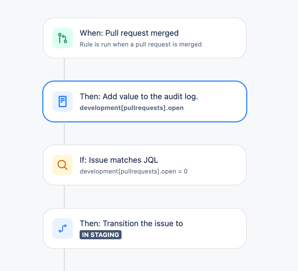

I have the below automation in place to transition an issue to an 'In Staging' status upon a PR being merged. It's been working up until a couple of weeks ago in which nearly all of the items are resulting in No Actions Performed. I've attached a screenshot of our audit log as well.
I've confirmed too that there are no open PRs associated to an issue that results in this No Actions Performed.

Can you add a Log action before the condition to write the value of development[pullrequests].open into the audit log?
In the Log Action put into the entry field the exact smart value you are using on the left side of the comparison.
You need to cause the rule to execute again for an issue that you believe has no open PR's. Then look at the log and see what appears in the Audit Log for that Log Action.
@Trudy Claspill This is the result of the latest execution (on a ticket I know for sure has only one PR and it's been merged)
I apologize. I thought it would be a simple matter to print the number of open pull requests but based on my additional research it does not appear to be a simple matter. Go ahead and remove that Log action.
Since the rule is saying the issue doesn't match the JQL I was trying to ascertain what the value of development[pullrequests].open was at that moment.
Given that your rule matches the rule template provided for this scenario, I would expect the rule to work if the issue truly has no open pull requests.
