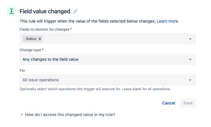

The trigger is as simple as this:

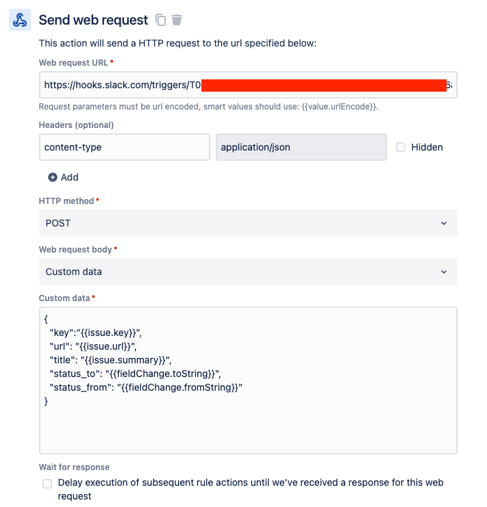

The action is a webhook with the following custom data:
"key":"{{issue.key}}",
"url": "{{issue.url}}",
"title": "{{issue.summary}}",
"status_to": "{{fieldChange.toString}}",
"status_from": "{{fieldChange.fromString}}"

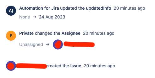

These are the actions that happened at the same time the automation was triggered, although I can't point out exactly when it happened:

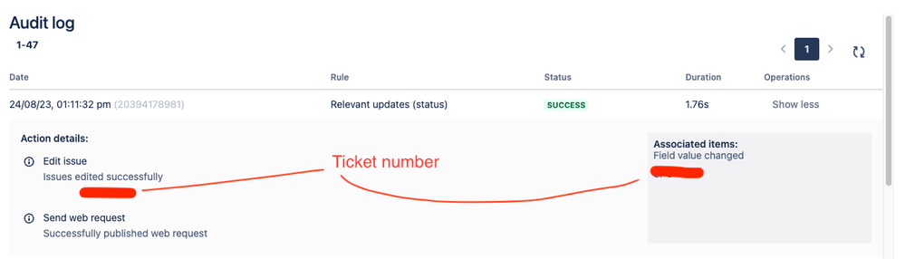

This is from the audit log if it helps:

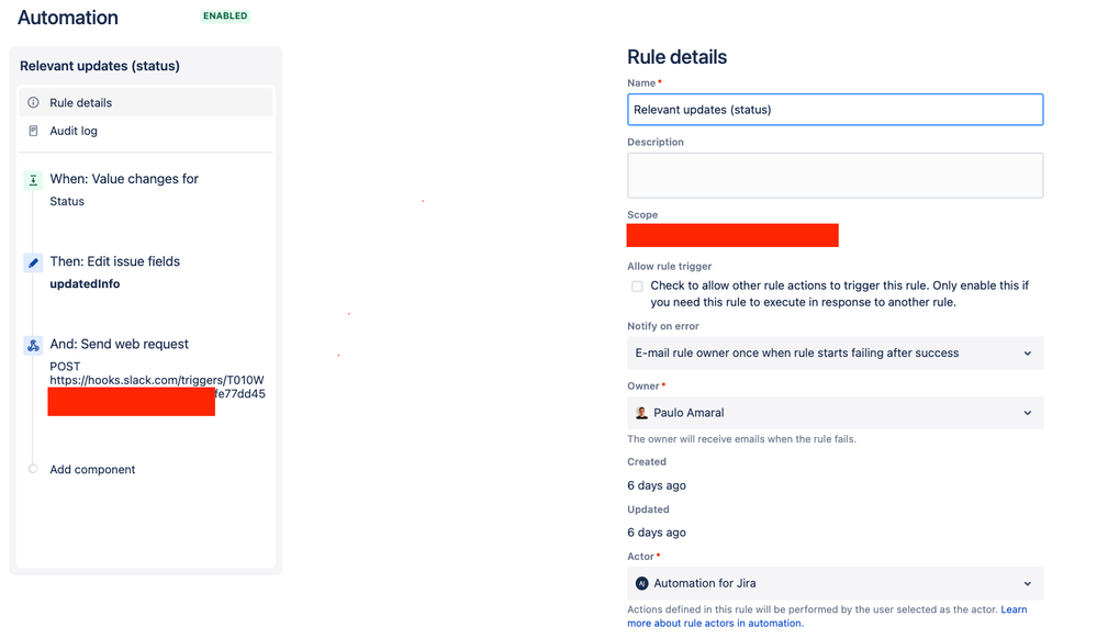

Entire automation:

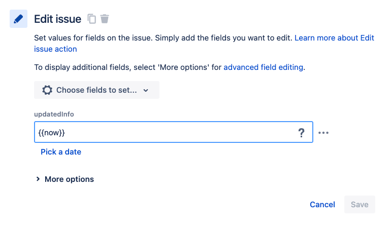

Extra field "updatedInfo" (I use it to track some important updates in tickets):
Action to post to a Slack webhook (will notify a channel):

Ah, I got it...Your rule is triggered on Field Updated, for status. And (surprisingly to me) that rule is triggered on new issue creation!
In this edge case, {{fieldChange}} contains the bean as this is moving from "no where" to your backlog (or another status). The hint of this is the "from" is "new". IMHO, this is a defect for the API...but that may be intended behavior for a good reason.
To solve this...What do you want to detect? If you only want to detect an issue status change, please change your trigger to Issue Transitioned.
