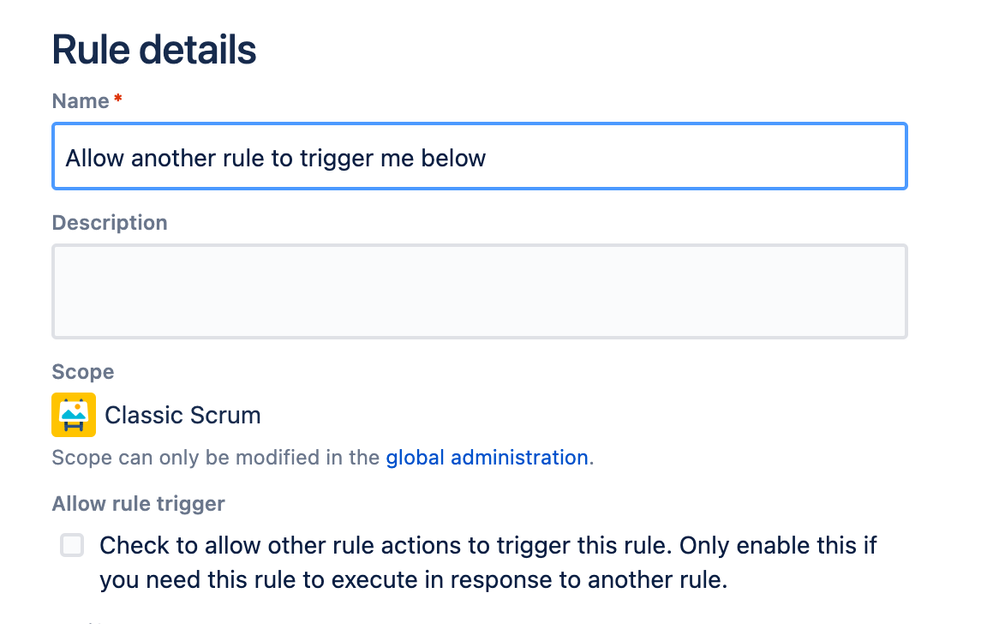

Am I correct in saying you have an automation running that clones this issue and you want this automation to kick off a separate automation?
If that is the case please make sure you allow the rule to be triggered by another automation. You'll find this on the rule details page:
Let me know if that helps!

We appreciate the effort to help on this one, but a coworker has figured it out. Thank you to Trudy and John on this. John was correct and his suggest is in line with the solution we found. We basically needed to set them in order.
