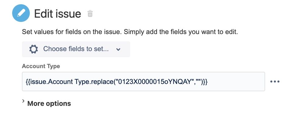

I have a custom field "Account" and some data has been placed there which I now want to remove in bulk... example..
Bookings - Mid 0123X000AAAAANQAY
The field type is 'Text'
How can I use Jira automations to seek out '0123X000AAAAANQAY' and replace with '' (nothing/delete it). I want to keep all other text in that field in tact.
So 'Bookings - Mid 0123X000AAAAANQAY' should become 'Bookings - Mid'
Thanks in advance!

Thanks Bill! It worked!
For anyone else wondering the same here was my solution. I used the edit issue action and pasted in the replace smart value...
