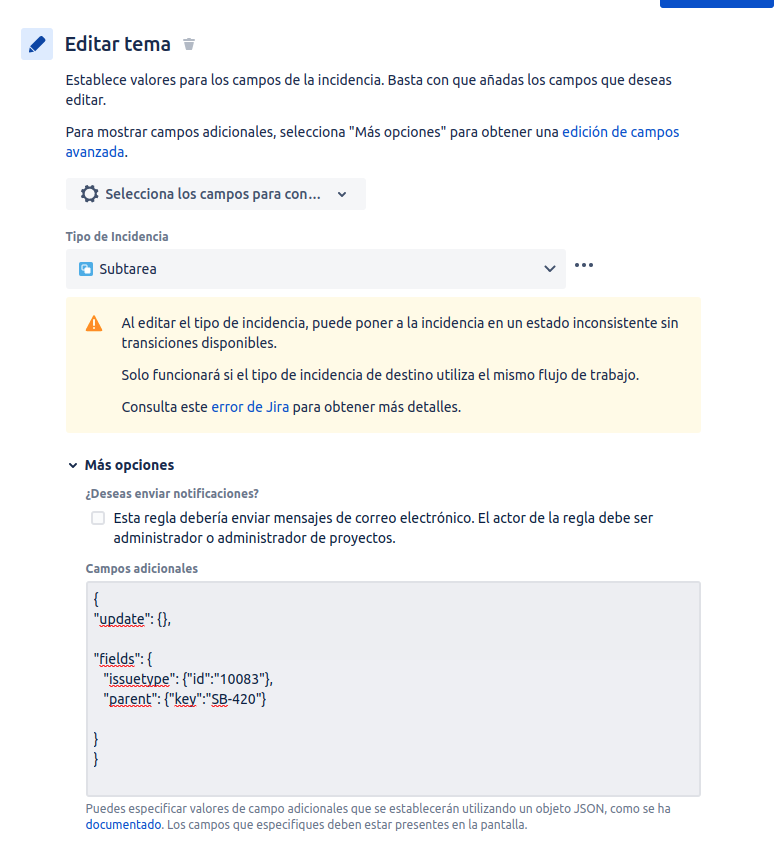

I am working with an automation that moves a TASK to a SUBTASK. In fact, until yesterday it was working correctly (No changes have been made to the project configuration or automation) but today I found that it is giving me the following errors: (The selected issue type is not valid. (issuetype))
I use the "Edit fields" action for the issue type, but I also use the advanced options to determine the "parent" issue. Here is a screenshot of the configuration:

It is necessary to make a "move", because I need:
- Change the type of incidence from TASK to SUBTASK
- Indicate the "father" TASK of the new SUBTASK (I do this with a custom field, I have made a simpler automation to not complicate the matter and isolate the problem).

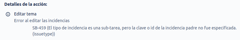

If I don't indicate the "parent" TASK, I get this error:
(The issue type is a sub-task, but the key or id of the parent issue was not specified. (issuetype))
Do you know of a different way to do this from an automation?

The parent isn't hardcoded in the main automation, it is taken from a custom field, like this:
