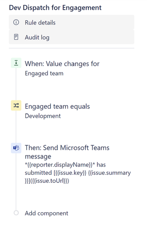

I have an automation configured that will ping a Microsoft Teams Channel when a value changes for a custom field named "Engaged Team" (When: Value changes for Engaged Team > Engaged Team = [value] > Then: Send Microsoft Teams message). This helps our teams with escalations.
The automation(s) work great when I change the value of the Engaged Team custom field from the view issue screen. However, when I change the value from a transition screen, the automation doesn't work. In fact, the automation isn't being triggered at all as there is no entry in the automation logs.

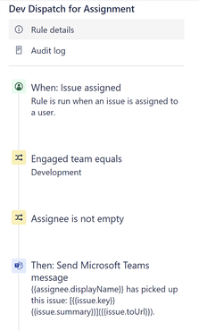

What's weird is that I have another automation that pings Microsoft Teams when an issue is assigned and whenever I change that field from a transition screen, the automation works. So it seems as though the issue is isolated to the custom field "Engaged Team" or the Trigger "When: Value change." By the way, I could understand if the automation didn't work perfectly if both fields were changed on the same transition screen. That was not the case on my test. All I did was change one or the other.

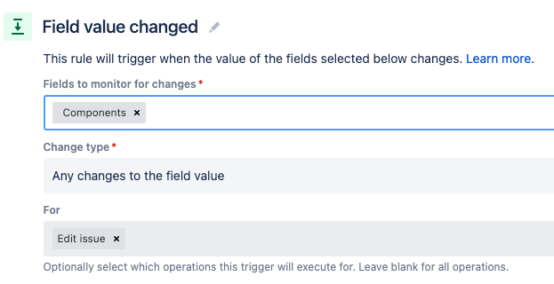

In the trigger, what do you have for the For Operations field, where the example below shows "Edit Issue"?

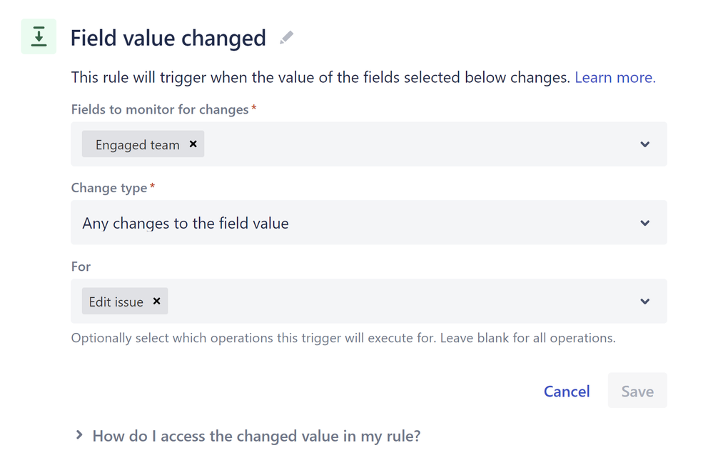

Ted Korba December 23, 2022
Hi @Trudy Claspill ,
This is what I have:
I see where you are going here. I added "Transition Issue" to the For field and problem solved!
