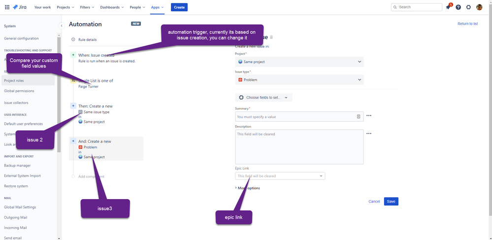

Welcome to Atlassian community. If I understood correctly, you want to create two more issues based on custom field values and associate them with epic.
Yes , it is possible, please have a look at attached screenshot. Please feel free to reply back if my assumption is wrong so can help you in better way.

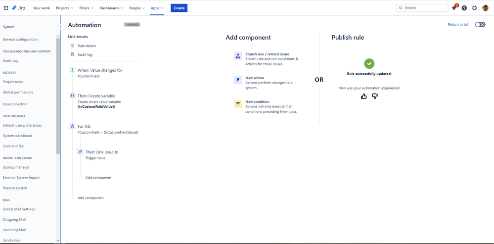

So you can't achieve it by above way.  Here is new way. Please have a look at attached screenshot.
What I did, I saved the triggering issue(epic) value in a variable and used that value to execute the JQL then linked the resulting issues with the triggered issue.

Javier Cárdaba January 19, 2021
Dear Muhammad,
I have arrived to the solution you have summarized in your feedback, so... THANK YOU!
