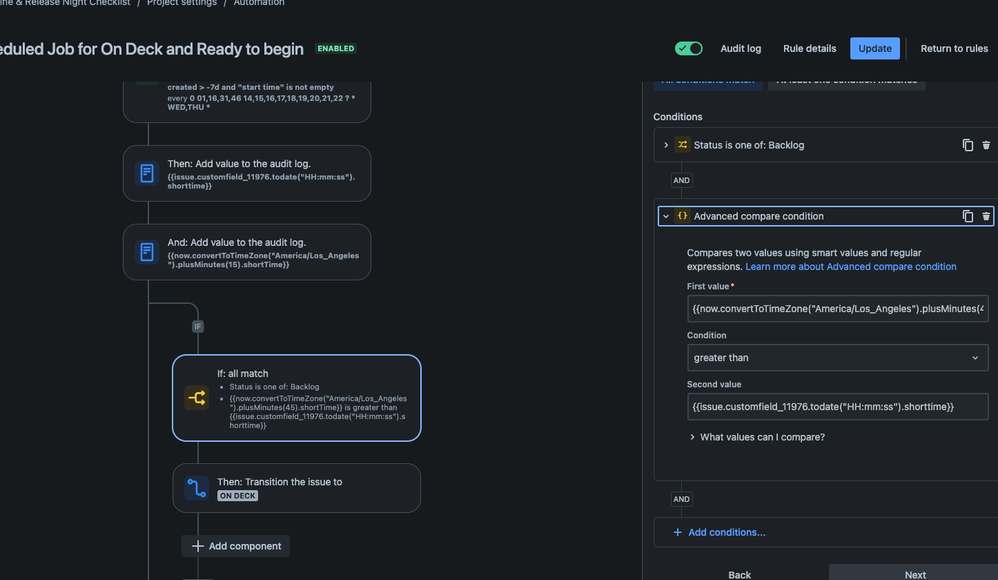

We have a process that is supposed to begin at a certain time (3 PM).
When it hits 45 minutes before the task is supposed to begin its supposed to transition it from Backlog --> On Deck
When it hits 5 minutes before it is supposed to transition it from On Deck --> Ready to begin.
However both of these rules do not work the way it is supposed to.

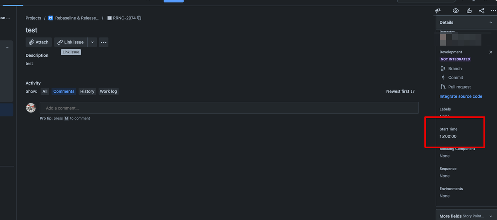

We have a custom field called start time, its a free text field.
First if statement
{{now.convertToTimeZone("America/Los_Angeles").plusMinutes(45).shortTime}}
greater than
{{issue.customfield_11976.todate("HH:mm:ss").shorttime}} (this is the start time field)
Then it is supposed to transition it only if its within 45 minutes of the start time, but it always transitions it no matter whatMonosnap Automation - Jira 2023-11-15 10-16-01.pngMonosnap Automation - Jira 2023-11-15 10-15-25.pngMonosnap [RRNC-2974] test - Jira 2023-11-15 10-17-23.png

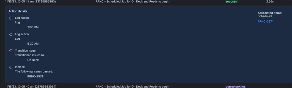

The way you have written the comparison, it is simply comparing that now + 45 minutes is later than the scheduled start time.
I can also hypothesize that there are two other factors that may be influencing the comparison.
1. You did not convert the start time to a particular timezone, so it may be getting interpreted as UTC. In that case 9:20 am LA time is indeed later than 3:00 pm UTC.
2. Possibly, but unlikely, the comparison is being done as text rather than time.
