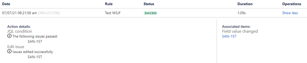

The second option appears to be accepted...but it's not populating the WSJF field.
I have the success message:
But the field is blank:
Lucy

I was getting this error message:
However, I am now using the expression:
{{issue.customField_10081.divide(issue.customField_10024)}}
This is showing as successful but the WSFJ field isn't populating:
Lucy
