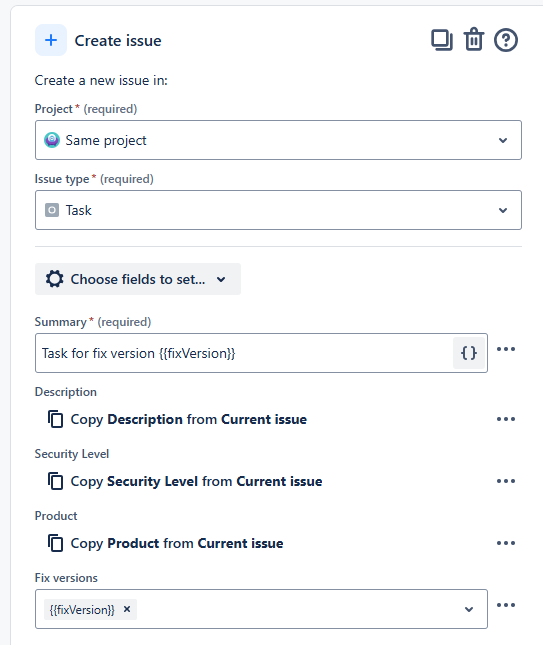

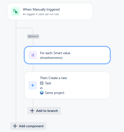

I created an automation rule to create multiple tasks for all the fix version present in the trigger issue using Advanced branching.
I am able to create multiple tasks for the versions in the trigger issue but the fix version field value is not getting updated.
I tried to use {{fiversion.id}} and {{fixversion.name}} too, but didn't work.
Could you provide some assistance on the same.

Please show images of your Advanced Branch and the audit log details.  Those will provide context to explain the symptom.
Also, when using variables (such as with Advanced Branch and Create Variable) I recommend adding a prefix to the name to avoid people and rules getting confused by any smart value overlaps.  For example, naming the branch variable varFixVersion.

thanks for your quick response, issue is resolved now . i am using the wrong variable
