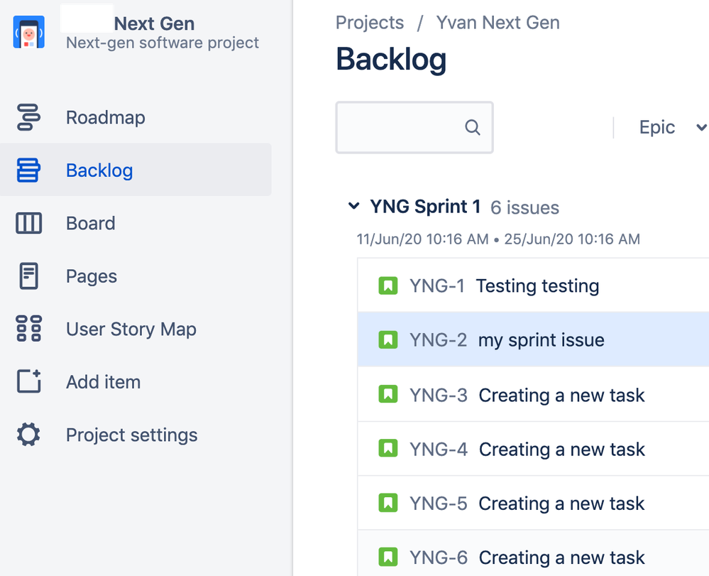

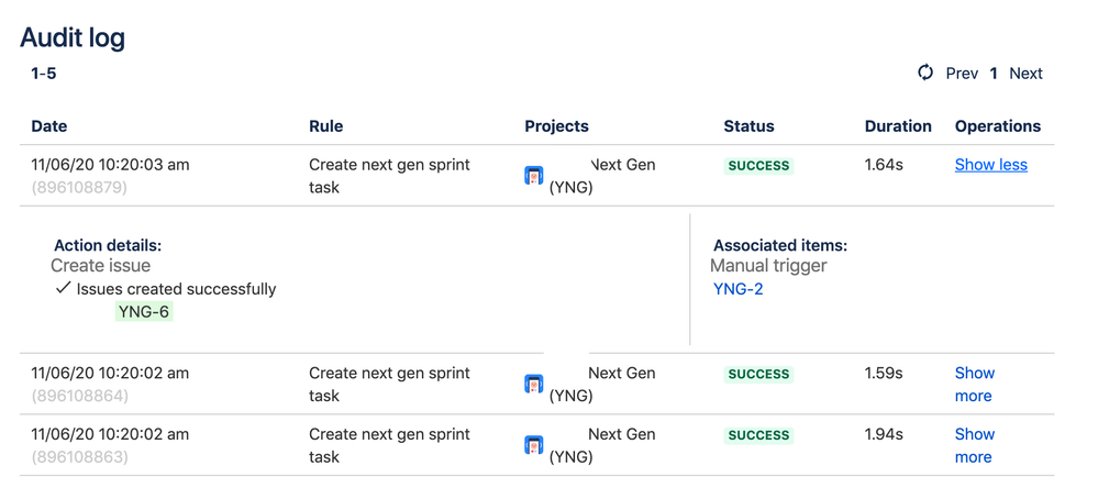

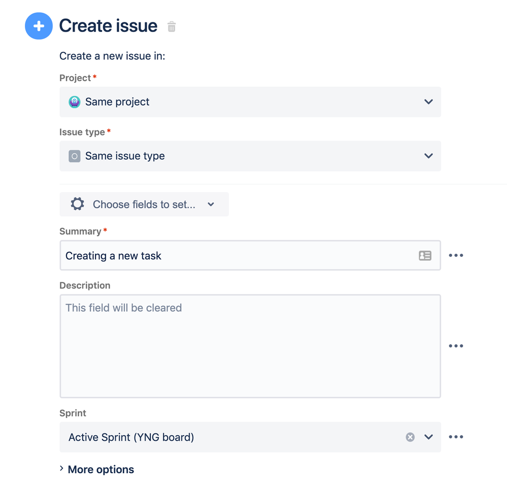

I've just tested the same scenario and had no issue editing/creating issues with the active sprint set from a next-gen project. Can you confirm this is the case, and what exactly is or isn't happening instead?
You'll need to ensure that you created a nextgen project with a scrum board (doesn't work with kanban), and you'll need to start a Sprint first if you haven't. Make sure to refresh the page after running the rule if you haven't, and you can find any success/error information in the audit log section after clicking "show more" on the failed execution.
As a note the sprint field only works with scrum projects with a board, not kanban.
