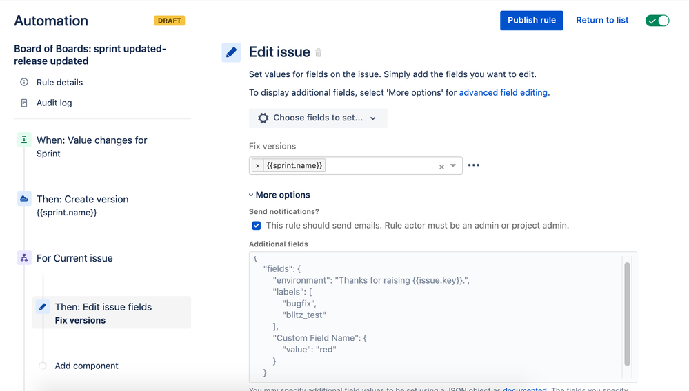

I have created an automation rule to edit the 'fix version' field with {{sprint.name}} in the current issue, when the sprint changes.
Unfortunately what it does is 'add' sprint name, rather than wipe the field and replace it with the new name, so that I end up with fix versions called 'sprint1.name'-sprint2.name'-'sprint3.name'-sprint4.name'
Is it possible to specify how the value should be changed? Maybe in more options? screengrab below

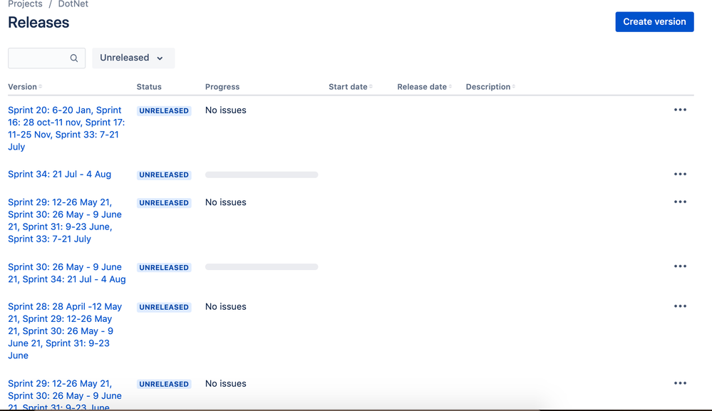

it adds the sprint name to an existing fix version name somewhere, i just have no way of seeing where. it creates these versions, see below

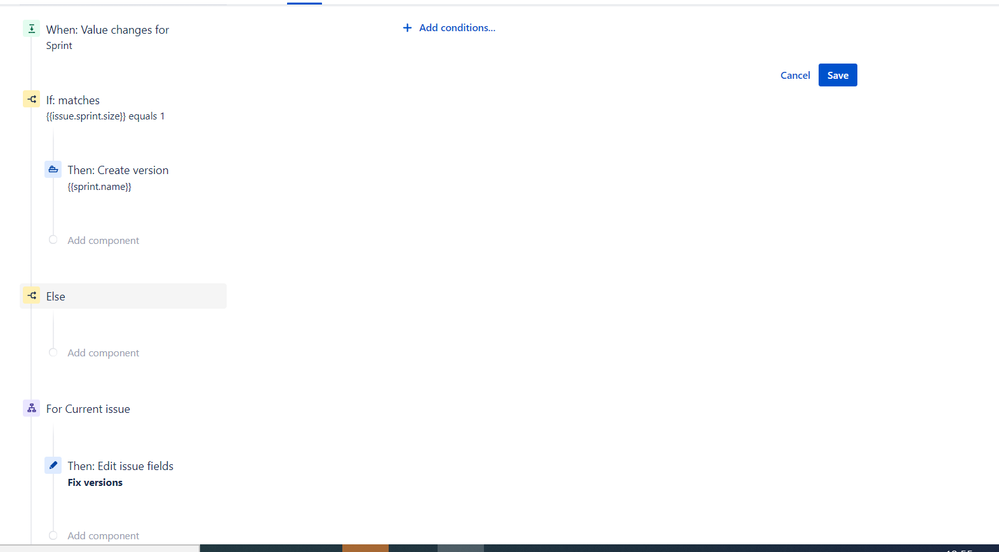

Given these are two list fields (sprint and fixVersion) I can think of two possible solutions, both with assumptions:
  • With the shown rule, assume there is at least one story with one-and-only-one sprint (the current one), and so add a condition to confirm that before creating the version:  {{issue.sprint.size}} equals 1

l bascle
July 1, 2021
Bill, yes you are totally right. Stories don't get completed in the sprint when they were started (boo!), and get carried over from sprint to sprint, so a story is assigned to multiple sprints.
I am not sure which approach from those you suggested is the best... the easiest?
- I tried to implement the first one, but need to define an 'else'. see belowautomationrules.png

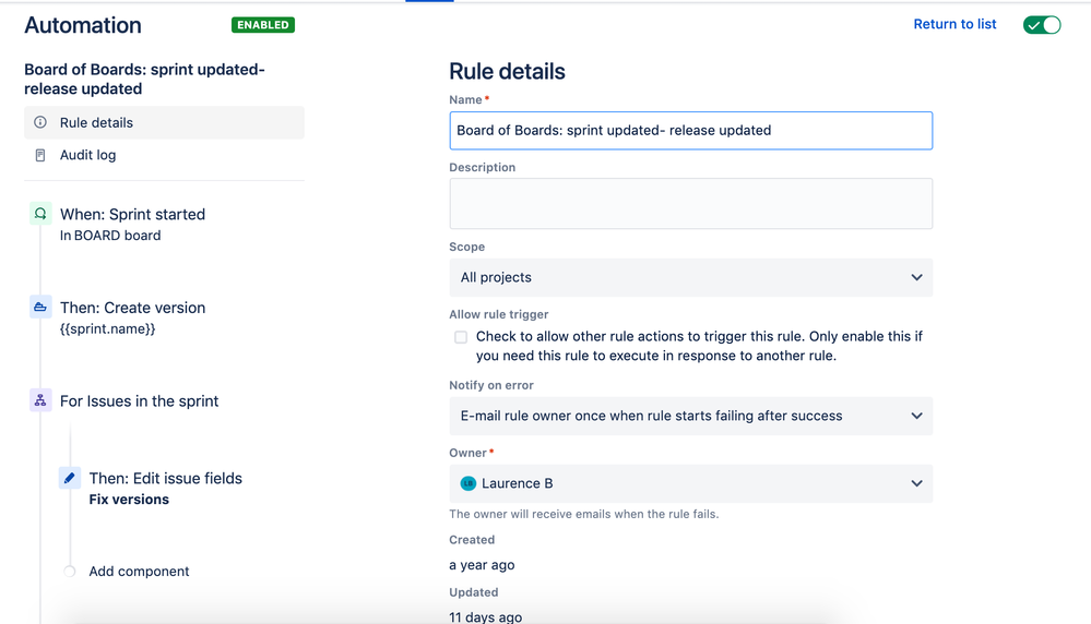

l bascle
August 1, 2021
HI Bill!
Sorry for the delay from me! I was on leave, and then had to wait for a 2 week sprint to begin to see if the rule worked. This is the rule I had in place, but it seems to have failed to change versions

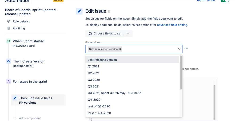

l bascle
August 2, 2021
I suspect it is the value choice in fix versions that is not right, see belowScreenshot 2021-08-02 at 08.56.57.png
Bill Sheboy
August 2, 2021
Hi @l bascle
Please try to type the same smart value {{sprint.name}} directly in the value for the fix version edit.  When you finish typing, the smart value will appear below the field, and you may select it.  That should use the same value which you used when creating the version.
And...if you do not want to wait to test this until the next sprint, I recommend creating a test project solely for experimenting on rules.  Then you may start/stop sprints as needed for testing, and not impact your main project in Jira.
Bill

l bascle
August 3, 2021
Thanks @Bill Sheboy , that finally did it!!! So happy, had been trying to do this for so long!
