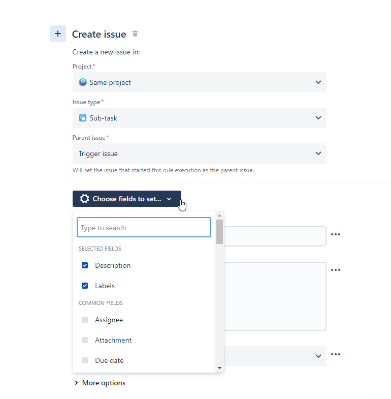

Is there some field-edit-action within the creation of the subtasks? As the screenshot shows there might be some initial setting when you create the subtasks. Could you please also show the content of the actions as well as the audit log?

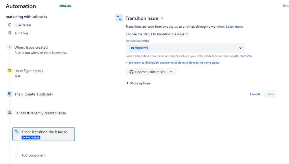

I tested the behaviour within my site and it worked fine. I also immediatly transitioned the status of each subtask with a "most recently created issue" branch after each subtask creation (see screenshot):

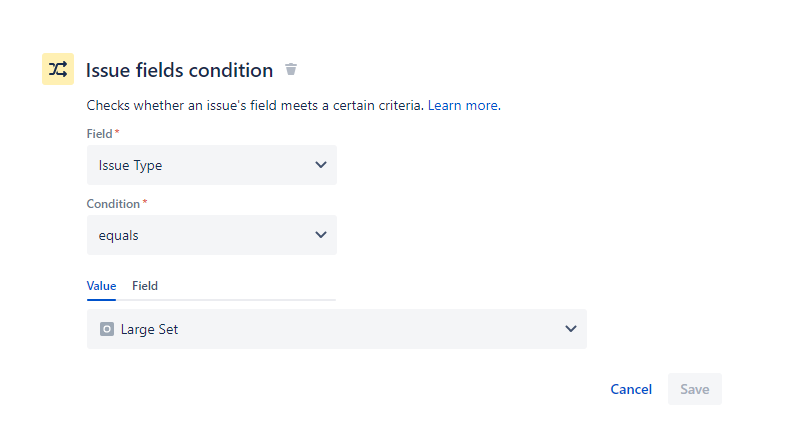

So the rule goes:
- when issue is created (I changed nothing there),
- issue type equals - here I set it as follows:

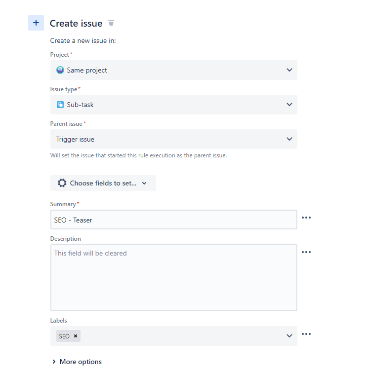

- then create a new sub-task, with the following settings:
I also selected label, because 2 of these 9 sub tasks should go on the SEO board, 1 to social media etc:
I created the same trigger ("Then create a new subtask"), but with different lables, 9 times.
Thank you for the tipp on creating the status transition within the rule! These are on stack so if I create the one for SEO first and this one has the "most recently created issue should be moved to SEO TO DO", and I then create one for social media, I could use the same branch logic, to move that subtask then to SOCIAL MEDIA TO DO?

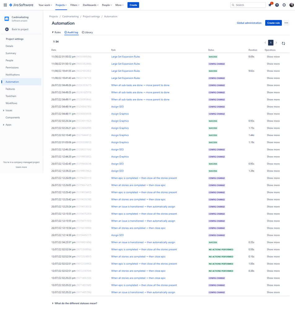

Ajda Gruden August 11, 2022
And the audit log:

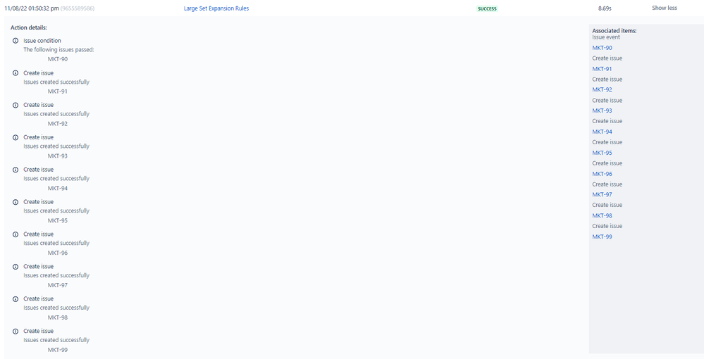

Stefan Salzl
August 11, 2022
@Ajda Gruden
Please open the details of the audit log by clicking "show more"
@Stefan Salzl
Omg, the issue is gone!
"Success":
Actually this audit log was very useful, because seing the issue links I clicked one and they vere actually created. Opening the ticket again and all the sub-tasks are there! So it must have been just a sync issue...
Thank you so much for your help and so sorry for wasting your time. Had I been more patient and checked periodically, I would have found out eventually...
Now all I have to do is figure out the status transition branches and I'm done :D
