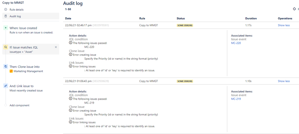

I am running an automation that clones a created issue into another project and then links the new issue and its clone. The rule has worked more times than not, but is failing randomly. The only correlation I can find is that the users creating the issues that fail are not users of the project. However the project has the standard permissions which allow non users to create issues. Just wanted to see if anyone knew why it would fail in these instances, or if there is another issue going on. I have attached my automation and the log
You have to have a issue Priority or the rule won't run for some reason.
have we found a solution for this error? I just got this error message when cloning an epic with multiple tasks.
I believe the issue may be that you can clone an issue where you are setting the priority to NULL (i.e. the original issue priority is also NULL). I am currently battling the same issue

That doesn't seem to be it. Priority isn't a required field in either project. I also tried to remove the priority value from the creation form, but that didn't recreate the failure. It just re-populated the field.
I think this may require some debugging - looking at specific examples of issues where this passes and doesn't pass. I'd create a support ticket at https://support.atlassian.com/ and provide as much details of the issues as you can.
