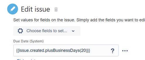

The user is updating a field (Network Type) in the parent to one of 3 values (Simple, Standard, Complex). The automation will kick in and change the due date on the parent as follows:
Simple = {{issue.created.plusBusinessDays(20)}}
Standard = {{issue.created.plusBusinessDays(20)}}
Complex = {{issue.created.plusBusinessDays(60)}}
This part of the automation works great

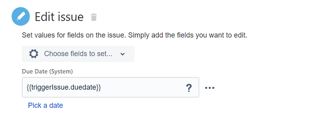

When the automation branches to the subtasks I set the subtask due date to {{triggerIssue.duedate}}
Unfortunately, the subtask due date is set to the original parent due date, not the updated date.

Thanks Bill, here are some images:
For the Simple network type:
Then later in the automation:
I hope this helps
