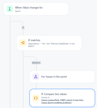

Thanks Bill. I was able to create the conditions and check the values of the sprint end date and Delivery date.

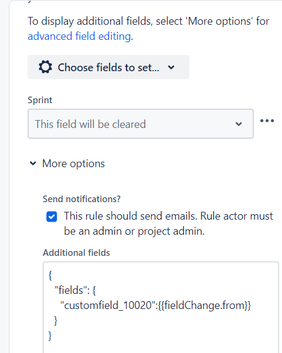

I managed to use the field change in the advanced editing part and it is working but partly.
else consider as an error (e.g. delivery date = 15-Nov-2023, new sprint dates [01-Dec-2023;15-Dec-2023]
leave delivery date as-is
sprint = previous value (null or DEF)
end if
This is working fine when there is an actual value for sprint, in our case DEF. But for the case where it was NULL previously, it does not work and I get an error "Error while parsing additional fields. Not valid JSON."

Also, I have to check if the delivery date is within the sprint end date/equals the sprint end date (>= enddate, <= enddate), how will I do this as I only have options "greater than", "less than" and "equals". Should I be doing it separately? This part is a bit confusing for me.

For your first question, I believe you will need to conditionally set the sprint either to the from value or to null.  If that does not work, let me know so I can experiment a bit.

For the first point, believe you will need to conditionally set the sprint either to the from value or to null - This is not working. Grateful if you can send me the code/automation for this one?

  • The sprint field can in fact be cleared by just editing the field in a rule and leaving the value empty.  And so the rule conditions can just use the conditional logic to set the field to either empty or to the prior sprint id value, with {{fieldChange.from}}

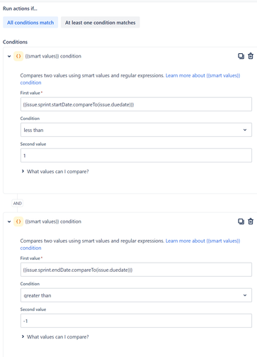

For the specifics of the smart value compare...
The first one tests if {{issue.sprint.startDate.compareTo(issue.duedate)}} is less than 1, meaning the start date is before, or equal to, the due date.
And the second tests if {{issue.sprint.endDate.compareTo(issue.duedate)}} is greater than -1, meaning the end date is equal to, or greater than, the due date.
