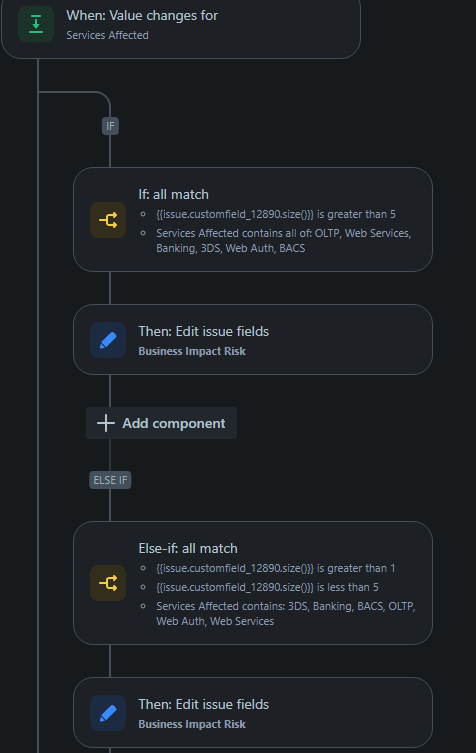

Here is my automation.
auto.png.
Basically imagine we have 10 services.
Services.
A, B, C, D, E, F, G, H, I, J
If someone selects one of "A, B, C, D, E" then the first part of my automation kicks in.
If someone selects all of them, then another part of my automation kicks in which isnt in the picture.
The issue I have is if 2-4 of them are selected, then I want the bottom part of my automation to kick in, which it does. But it will also kick in if someone was to select a number of "F, G, H, I, J".
How do I specify the automation to only "count" the services from "A, B, C, D, E"?
Jehan Bhathena
May 20, 2024
Thanks for the detailed explanation @Terry Dance ,
So If I'm understanding this correctly the second condition is :
  • "{{issue.customfield_12890.size()}}" > 1
  • "{{issue.customfield_12890.size()}}" < 5
  • If CF value CONTAINS "A, B, C, D, E"
Not if this is the scenario, then if anyone does select "F, G, H, I, J" it should not get triggered. Although your prime issue would be the "issue.customfield_12890.size" since that is currently not calculated as per your expectation.
What I would suggest is:
  • Try to add a negative condition to the second condition, i.e. CF should NOT CONTAINS "F, G, H, I, J"
  • Also, the issue.customfield_12890.size() will always count the F, G, H, I, J values too, what you want to do here if create a new Variable and then iterate over it for every value present in the issue.customfield_12890, and increment it by 1 for each time it find the A, B, C, D, E values. This new variable can then be used in your second conditional loop.

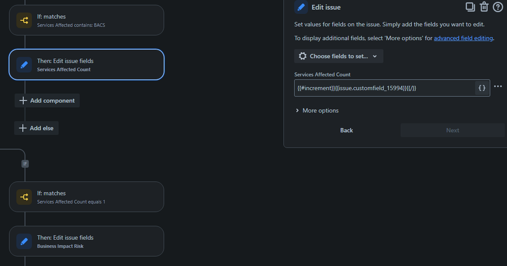

I did try creating a number field and incrementing it for every value from  "A, B, C, D, E",
But the last but in this picture just wouldnt work.
If only 1 value was counted, and counted correctly. It always fails at this "count field = 1", even though the field is 1 at this point.
Jehan Bhathena
May 20, 2024
Try adding a "Re-Fetch Issue Data" AFTER the field has been updated, the automation runs of the values that it receives when it was triggered, since you've update the value mid way you will have to inform the automation of the new value before using it in another loop.
Terry Dance
May 21, 2024
I've added a re-fetch after each update to the count field, but it still only updates the count once.
Is this math correct?
{{#=}}{{issue.customfield_15994}}+1{{/}}
Terry Dance
May 21, 2024
Ok sorted it.
My automation was
IF
EDIT
REFETCH
I've changed it to
IF
REFETCH
EDIT
Now it works
