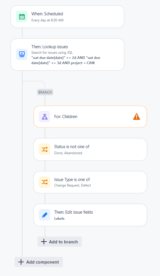

I am trying to build what feels like a simple automation but hitting a mental brick wall :)
Steps in my automation needed:
1) Run JQL to gather list of epics (the Then: Lookup issues part.  This works in a standard filter and returns the epics I need)
2) For every child issue of those epics that meets a specific criteria then edit the child issue.
I've tried using For: Children, but think I'm missing some step to pass information to the branch.
Any help would be appreciated!

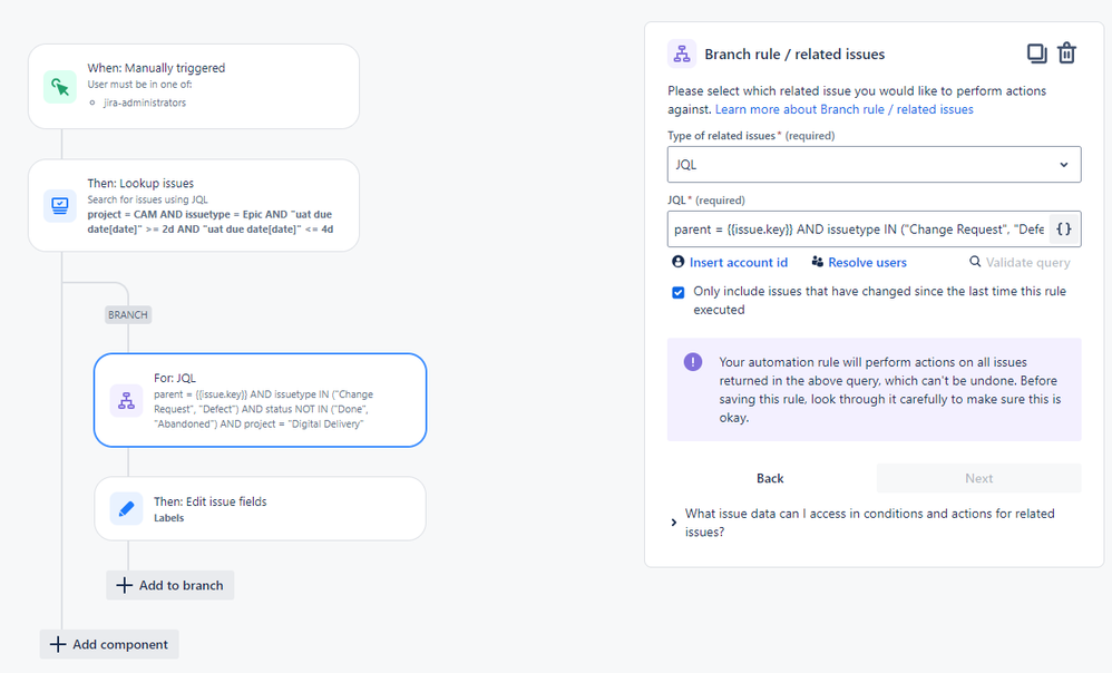

Aaron Hunt October 18, 2024
Thanks Bill
I think I'm still doing something wrong as this isn't itterating.  Perhaps I have the wrong branch?  I tried with a for each then another lookup but that didn't work either (same issue of it not itterating)
In the first lookup issues it finds two epics, but then when the branch happens it's only applying to one of the two.
The ones it misses are definately "in scope" insomuch as if I put the query into a filter, it finds all the relevant child issues. i.e. the filter is
Any ideas?

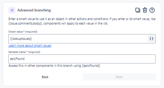

There is no option when using lookupisues and branch with children option.
Using lookupissues you can only do an advanced branch, based on using the smart variable {{llookupissues}} and give that variable a name.
This will iterate on the found issues in the lookup.
You could try to add another lookup in the branch.
I didn't test it, but here is the example I built.

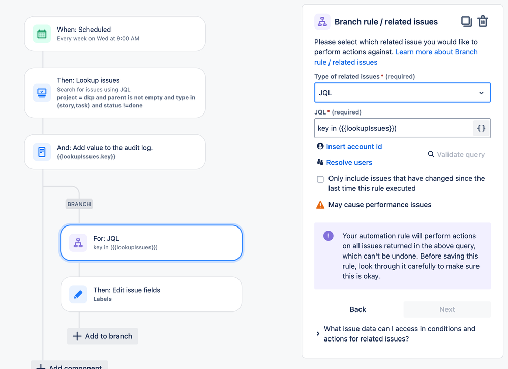

Aaron Hunt October 16, 2024
That's partially working, in that it's picking up one of the child tickets and updating it, but it doesn't appear to be iterating.  Can you share what you entered into the For each part?  I have this, but I'm unsure if I need to go deeper than the lookupissues part?

Hi @Aaron Hunt
They way you want this will not work as it would require a 3rd level branch, that is not an option.
We could look at searching differently.
Find the issues of a certain type(s) in a certain status(es) in a certain project(s) and parent field is not empty.
Place that in a lookup and then branch based on JQL
I tried it and it worked on my side.
