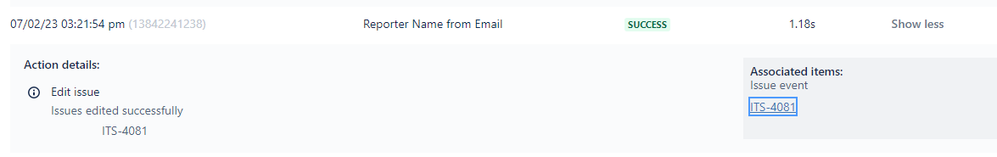

Thank you!  I tried this and now the Reporter name is coming in as Anonymous.  I also checked that the email address is associated with the Atlassian account and it is.
Here is the audit log:

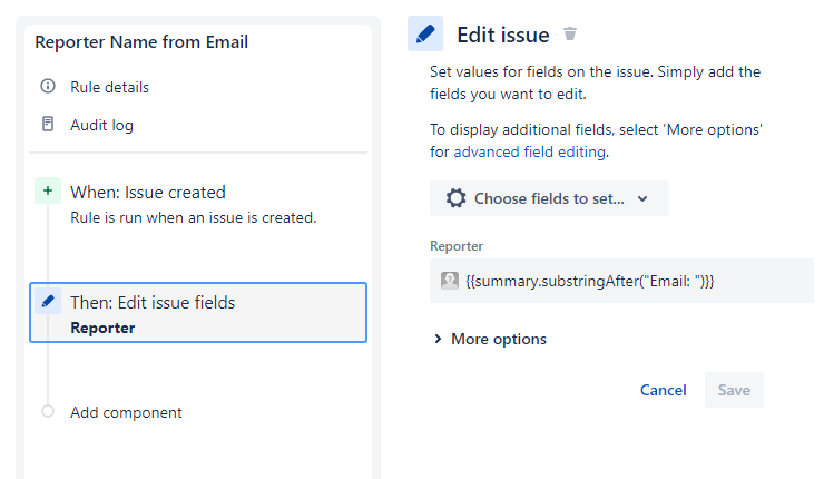

Can you please send me the screenshot of your automation rule and how you are assigning the value for reporter field?

Alexandra Astor
February 8, 2023
Sure!  Here it is:
