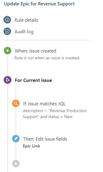

Hello all,
I am trying to use the automate feature within Jira cloud to do some conditional operations when an issue is created.  I want to check the description field to see if a couple different values are found.  If one of the values is located, then to assign the appropriate epic to that issue.  I am having no luck and can't see to get the update to occur even though the JQL that I have comes back with the match I expect.  Below is a section of the automation that I am using.  I have three sections that are identical except for the description value and the epic link they correspond to.
Any help would be greatly appreciated.

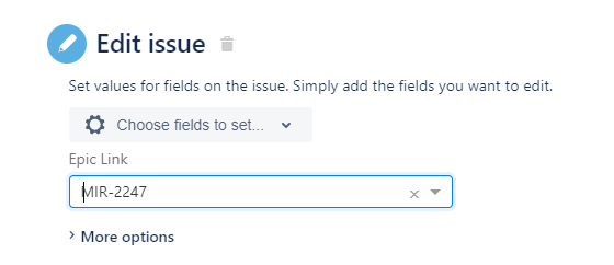

Close up of the Edit issue fields section:image.png
