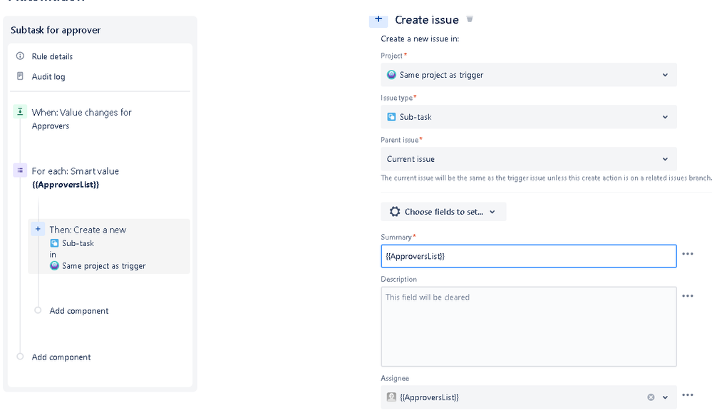

I have a rule that when the value of the approvers changes, it creates as many subtasks as the approvers in the list and assigns also each subtask to each approver as shown in the screenshot below: This works fine and as expected.

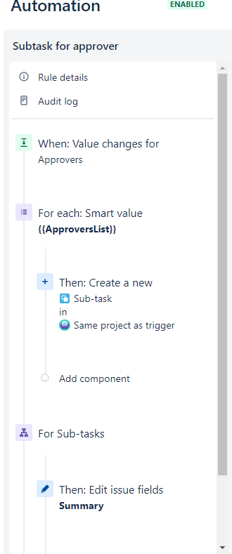

After this i branch the rule for each subtask and i edit the summary of the subtask to show the assignee name of the subtask with additional text .
It works only if i have one approver. if i have 2 approvers it executes first this branch and then the For each with a consequence that the assignee name is not passed to the subtasks

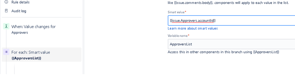

This is how the smart value is written: {{issue.Approvers.accountId}} and I use the ApproversList variable so then in the create subtask to create as many as the approvers and assign each subtask to each approver. Till that point it works fine.

Here is also the screenshot of the variable and the smart value, and below that is the subtask creation
If i put into the summary the variable smartvalue {{ApproversList}} it will add a single approver in every subtask but with the account id, as this has been declared in the variable creation since the assignee works with the account id as from what i have read

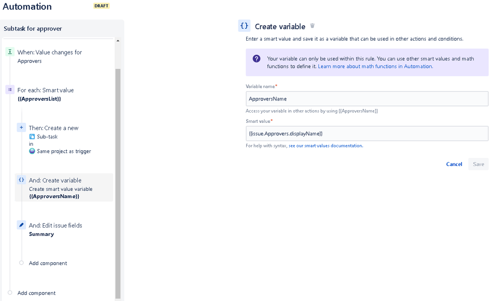

What i did is that i added another variable to get the display name of the approvers and then edit the summary with this variable, but in this case it adds the names of all the approvers in each subtask. What am i missing here

  • Use the entire Approvers field in the advanced branch smart value {{issue.Approvers}} as that will provide the entire user object to the branch iterations (as described in this article)
  • Then in your sub-task create you may reference the variable's fields, as needed:
    • {{ApproverList.accountId}}
    • {{ApproverList.displayName}}
