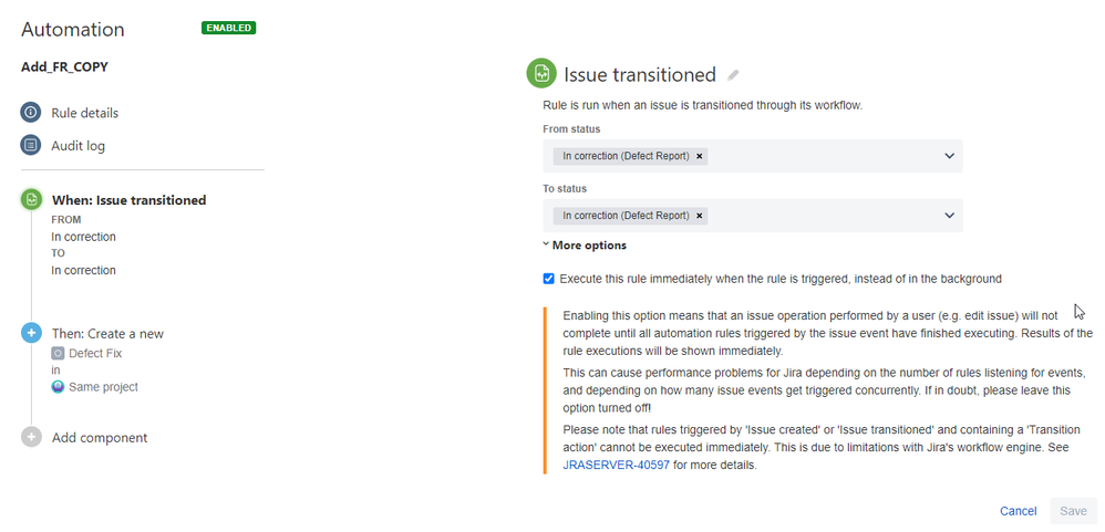

Could you share a screenshot of the configuration of your trigger?
Rachid El Mansouri April 21, 2022
Hello @Mykenna Cepek
Please find attached the configuration of the trigger
Mykenna Cepek
April 21, 2022
Have you tried disabling the "Trigger > More options > Execute this rule immediately..." setting? It's pretty clear about performance impact.
@Mykenna Cepek Yes we have tried disabling with no more success.

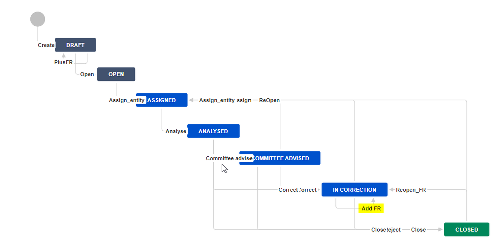

Why does your trigger use the same value for "From status" and "To status". That doesn't make sense to me.
Also, can you share a screenshot of the workflow being used by the project you are using for your testing?
We want to fire the trigger "Add FR" on the status "in correction".
Do you have another suggestion on how to do this ?
@Mykenna Cepek
I just tried changing the trigger from "issue transitioned" to "manual trigger" : Same behavior it's taking too long to execute

1. You are running this as a global rule - this means that any issues being transitioned will be evaluated again the rule. This could be a performance issue if you have lots of projects with lots of issues using these transition states. Advise: Try using a project rule, i e limited to one project, and see if this improves performance
2. Your trigger is transition from In Correction to In Correction - by definition transition should be between different states. I was expecting transition from two separate states, e g New to In Correction. Advise: review to ensure that you are using the correct states, and that these states are not use in other more frequently invoked work-flows
3. Review if you have other project automations or background jobs cannibalising your processing capacity. Project automation is AFAIK executed in a single thread with low(est) priority
