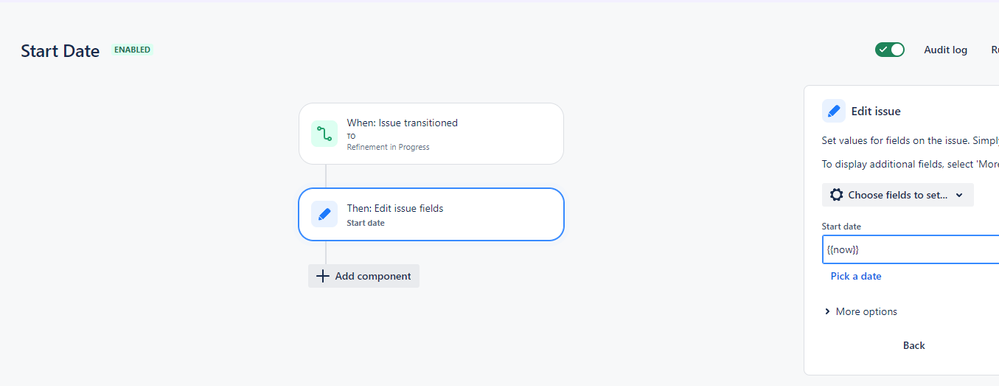

I have two relatively simple automations that work perfectly on their own:
  1. IF issue is transitioned to "REFINEMENT IN PROGRESS" status; Start date = NOW

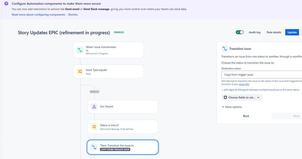

This works for all issue types that have that status.
We created another automation to have the EPICS status updated if its CHILD STORY was updated.
     2.  IF STORY is transitioned to REFINEMENT IN PROGRESS, then COPY THAT STATUS to its Parent. This also works perfectly.

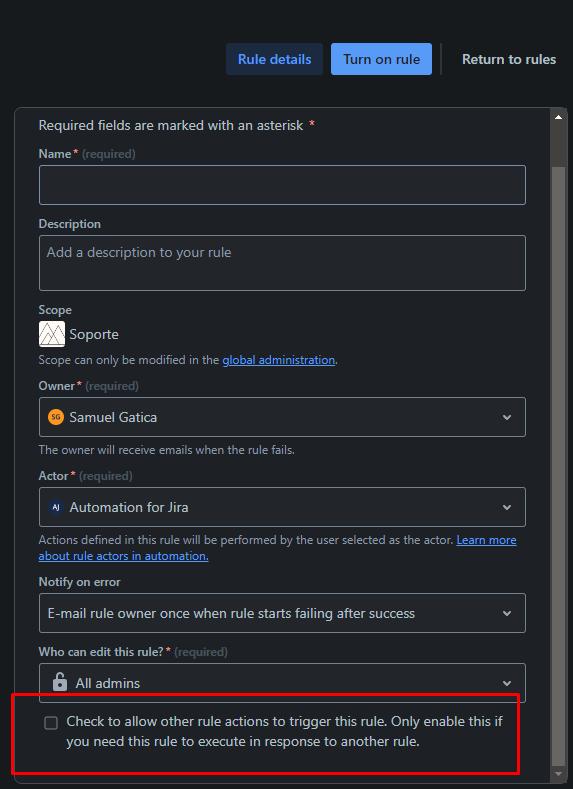

Hi @Steve Holland
Make sure the ckeck box "Check to allow other rule actions to trigger this rule. Only enable this if you need this rule to execute in response to another rule." is enabled for Automation #1
This way Automation #2 will trigger Automation #1
Best regards
Sam
Steve Holland
August 1, 2024
That was it..So simple! appreciate it @Samuel Gatica _ServiceRocket_ !
