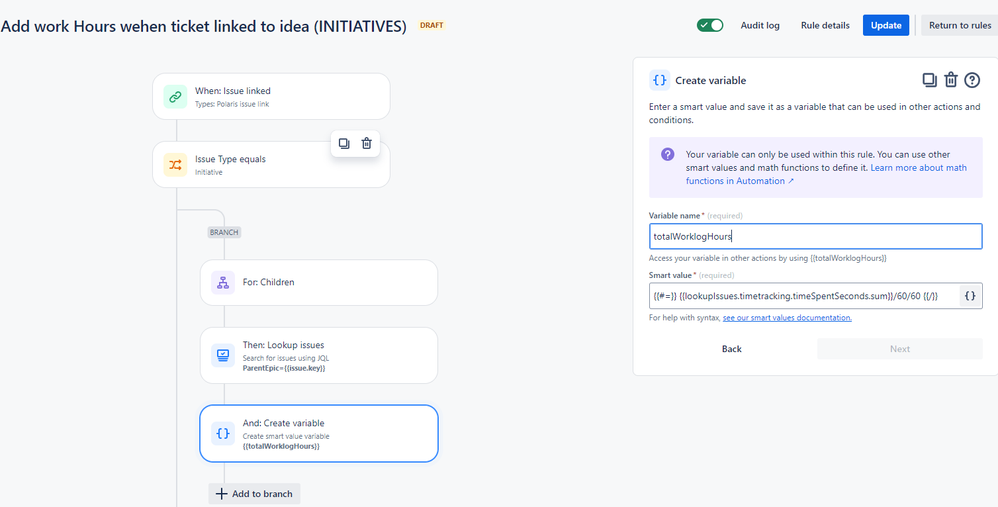

I am creating an automation that sums up all the work hours logged in all items under an initiative and add the number to a custom field in Jira Product Discovery idea.
My work-items tree looks like this:
Initiatives
Epics
Stories
Sub-tasks.
So I created an automation that runs in a branch on all the children of an initiative and sums up the work hours - this works good.
So inside a branch I aggregate the hours to the totalWorklogHours variable, but how do I add the value of the variable to the destination issue's custom field?
Normaly you would branch to destination issue, but you cannot branch from inside a branch.
Any creative ideas?
Thank you.

Hello @Nik Rogul
Which issue do you want to update? Which issue is the "destination issue"?
You started with an Initiative and branched to its child Epics. In the branch you are summing up the Time Spent of the child Stories under each Epic. Do you want to save that information to the Epic?
And then do you want to sum up all the time you wrote into the Epics and put the sum into the Initiative?
You may have some trouble accomplishing that in a single rule if that is your goal. The processing inside the branch will happen in parallel to any other actions you add to the rule. You can't depend on the branch processing finishing before the next steps in your rule are executed.
You could add a Delay action after the branch to pause the rule for the amount of time you think it would take to complete all that processing. Then add a Lookup Issues action to retrieve all the child Epics of the Initiative, and sum up the Custom Time Spent information you have added to them. However, that also might be a problem because the Sum function does not necessarily work with all custom fields in a Lookup Issues results set.
I have no experience with Jira Product Discovery and automation, so I can't address that part of your requirement at all.
Rolling up time spent information is a tricky endeavor when you are going through multiple hierarchical layers. You may want to consider if a third party app can help. You can see the discussion in this other post for some considerations of the challenges.
Thank you for the reply.
When you use "Issue linked" trigger, one side of the link can be referred by {{issue}} and the other side of the link is referred by {{destinationIssue}}
In my case an initiative is linked to idea, so initiative is an issue, and idea is a destination issue.
So I aggregate the work hours if the initiative (i.e. {{issue}}) and need to update the hours in a field of idea (i.e. {{destination issue}}).
Normally, when you work with link trigger, you can access the descination issue by branching to it, but when you are already in the branch, you cannot create another branch.
Normal "Edit issue" action will not work because it works on a current issue, i.e. on the initiative.
Jira product discovery is no different from Jira Software when it comes to automation as Ideas are normal Jira issues and everything that is applied to Jira works there.
I am aware that the branches run in separate threads, so I need to do the update in the branch itself, and that is exactly the problem. Unfortunately I cannot use variables too because there is no way to update a variable value.
So I am looking for a way to address in a branch an issue that is not this branch's current issue.

Now, as of summing up. I did not find a way to sum all work hours for an initiative as you can do for an epic.
For epic it is easy by looking up all the issues with ParentEpic function and then using
lookupIssues.timetracking.timeSpentSeconds.sum
Works great!
So i am running in a branch on all the children of an initiative (i.e. epics) and each branch sums up work hours for one specific epic.
I have no intention to write the sum of work hours to the epic itself, I need to add this sum to a field in the idea, so basically the idea will have a total work hours spent for the initiative that was linked to it.
And if there are 3 initiatives that are linked to an Idea, so to have a sum of work hours spent in all 3 of them by adding the hours for an initiative once it is linked.
