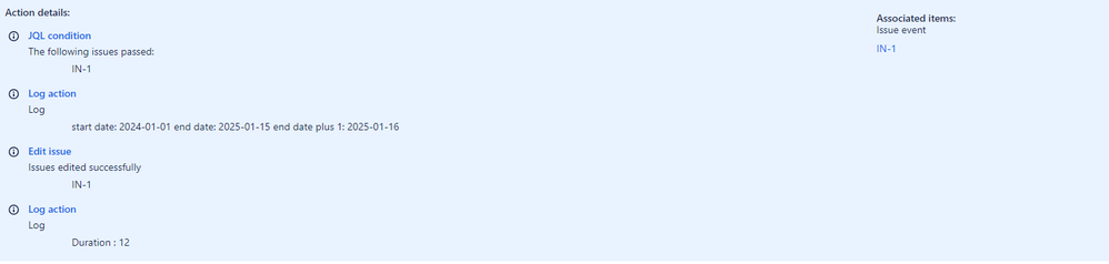

When I try that same smart value expression with two date fields it works and returns 12 months.
Let's try this to help diagnose what is happening:
  start date: {{issue.start date}}
  end date: {{issue.end date}}
  end date plus 1: {{issue.end date.plusDays(1)}}
This will confirm if your smart values are correct and if there are potentially multiple fields with the exact same names (and so which are confusing the rule processing).

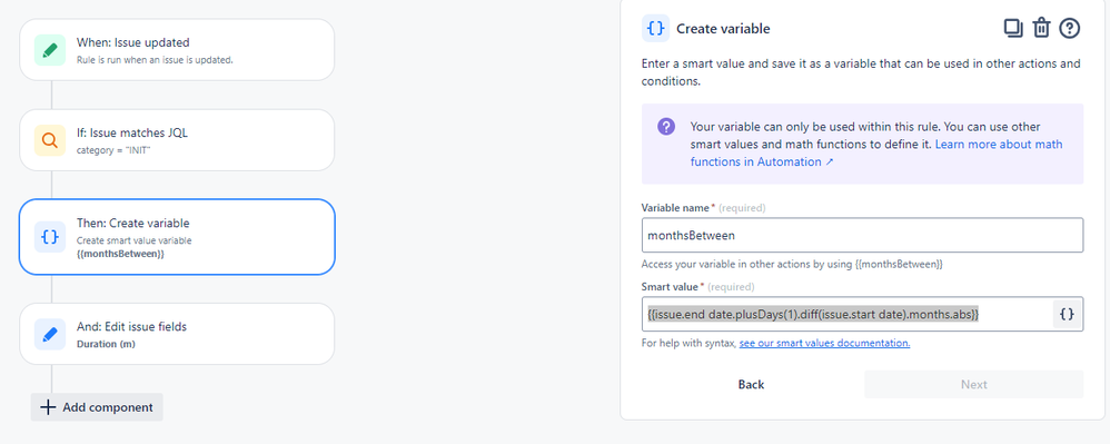

Hello Bill,
With the previous dates provided I am getting the correct result using plus 1 function, but if start/end dates changes how can I handle to round months ?
For the following example : I would like to count January to have 13 months as total
Thank you!
Thanks for that additional example to help clarify the need: you want to count the months difference including the end points (rather than just the difference in month values for the dates).
One solution approach is to change the end date to the endOfMonth first and then increment by one day. That will handle differences in the number of days per month.
{{issue.Start date.diff(issue.end date.endOfMonth.plusDays(1)).months}}
