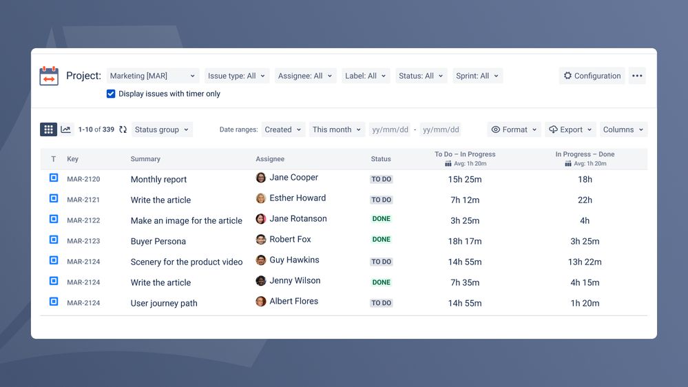

As an alternative , I guess you can try Time in Status for Jira Cloud (developed by my team). The primary purpose is to help teams gather valuable data about the lifecycle of your issues in Jira. Add-on allows you to measure and visualize Lead and Cycle time to help you identify areas for improvement.
For this you should create only status group and you will get Lead or Cycle time report in your dashboard.

Also Time Between Statuses will be an option for you too. This add-on, which measures connections in the workflow, through a transition time in specific issues. You can count Cycle and Lead Time by setting start/stop and pause statuses in the configuration manager. To detail the calculation conditions you should select the first/last transition to/from status. This add-on also developed by my team.
Add-ons have a 30-day free trial version and free up to 10 users.
