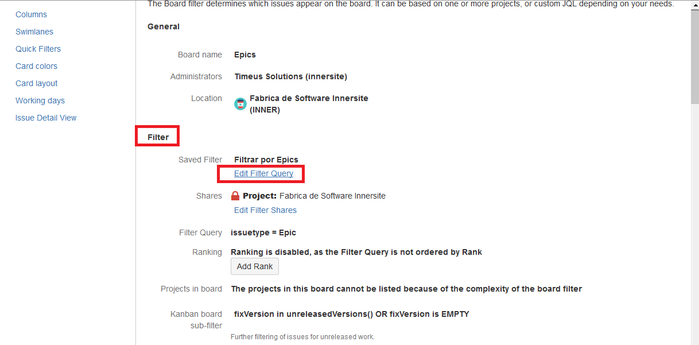

Hello, Yep, you can.
You just need to create a new board and edit Board Setting, as the image below:
After that, you need to edit your JQL, as the images below,
for example: [issuetype = Epic]

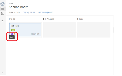

image01:
image02:
So, your board will show your Epics, or whatever you want, as the image below:

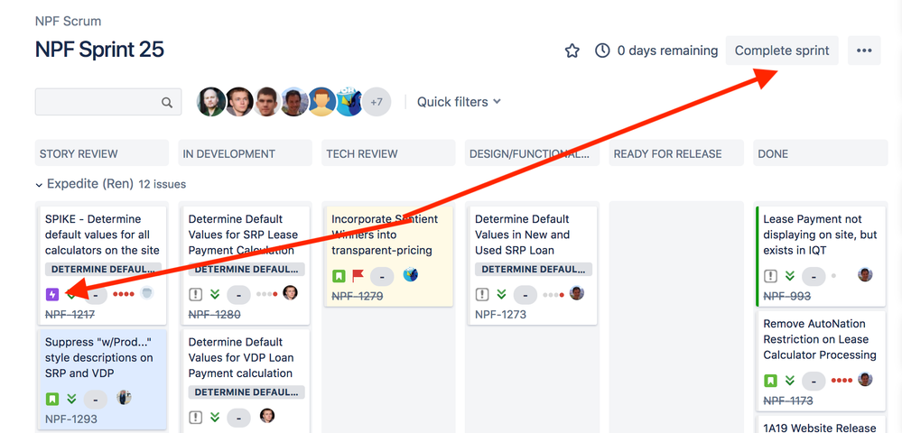

Maybe the functionality has changed. I have a Scrum board that displays epics.

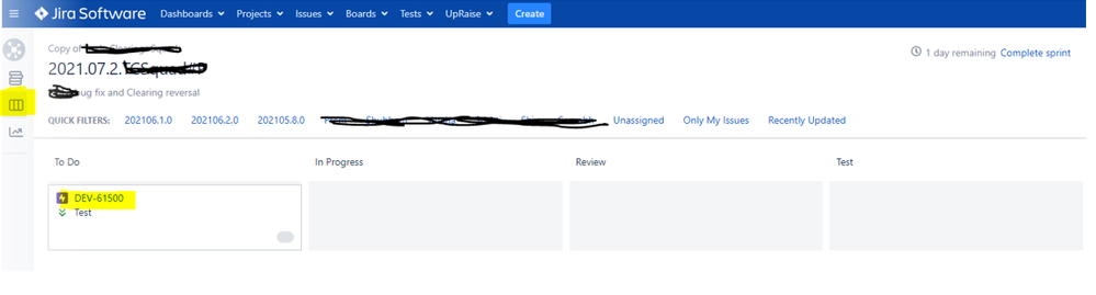

That said I was able to get an epic on the scrum board with a little trickery. I created a story, added it to a sprint and then changed the type to epic . I probably would not recommend this process as it is tedious and since it appears to violate Jira's paradigm, they could make a change that will break things in the future. And once I changed the issue type it no longer shows as part of the sprint in the backlog view. It still appears as part of the sprint in the scrum board view.
Good luck!

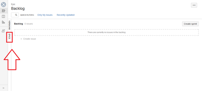

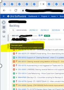

Epic can be seen in active sprint if they are assigned, as shared by @Renwick Oden in above post, however you can't see an epic in future sprint or backlog in Scrum Board even if its in there. 2 ways to see the epics, either to use Epic Panel (Vertically aligned on left side, see below highlighted in Yellow) to view epic and its progress.
OR
use Navigator view , It will allow you to see all issyetypes linked in any future sprints or backlog even if they are not appearing on board.
See below highlighted in Yellow,
Even if you convert any other type to an Epic in an active sprint, you wont be able to see it in backlog View .. See below
