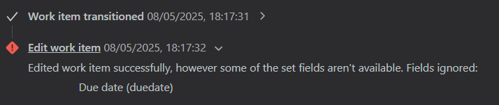

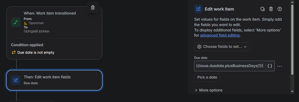

I have tasks transitioning from one stage of work (status) to the next, and along with this I need to add, for example 3 days to already set due date automatically.
I've added the action edit due date and tried smart values such as {{now.plusBusinessDays(3)}} {{issue.duedate.plusBusinessDays(3)}} {{issue.created.plusBusinessDays(3)}} but none of them work. I also tried adding conditions like due date is not empty. I also always add a condition to specify issue type. And I always get one error in the log (the field due date is available in the work types)

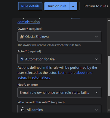

#1) Who is the rule actor in the details at the top of the rule?
The default is Automation for Jira, and that user should have the permissions needed for the rule. If someone changed the actor, why did they do so? I believe changing the Due Date requires the "Scheduled Issue" permission, and perhaps a different user does not have that one.

#3) The Due Date field is a date only field, and many of the smart value functions use date / time by default. You can enforce setting the field correctly by truncating the time part when setting the field:
{{issue.duedate.plusBusinessDays(3).jiraDate}}

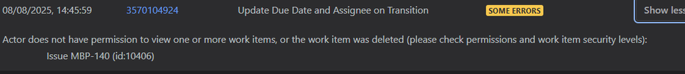

Here's the details
And the due date is created by another rule. When the task is created.

The rule actor is automation for Jira, and I didn't find the Permissions Schemes tab.

I tried the smart value you provided and the rule still failed.

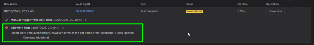

Thanks for that information, @Olesia Zhukova Let's confirm one of those and check another hypothesis.
Before we do that, would you please post an image of your complete rule in one single image and the complete audit log details for the execution? Those will provide better context to confirm we are all considering the same things. Thanks!

The error you get in the audit log indicate that the due date field is not on the screen used by the work item. Automations can only change fields that are on the screen.
I know right, but it's on there and I already have a rule working to create a due date when the task is created.

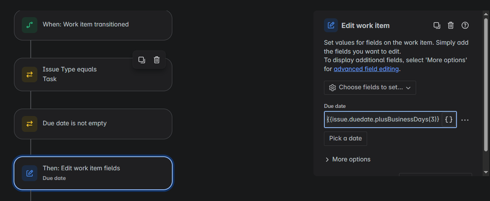

could you please also send a screenshot of your rule to see how the edit actions are configured.

My rules look like this mostly.

In the screenshot it only shows one closing } . But I guess this is only hidden by the end of the field.
Furthermore could you please send another screenshot of your rule details? Who is the actor of this rule in the details? Does that user have the permission to edit the the due date /schedule a work item?
