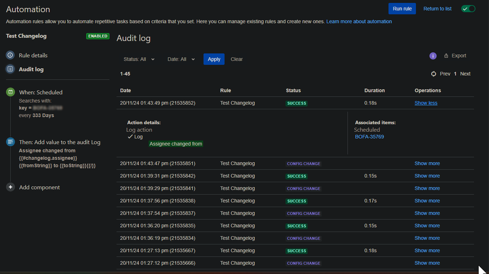

I'm trying to pull the previous value of a custom field that has already changed using automation. This is on Data Center.
Does this only work when the rule is triggered by a change?

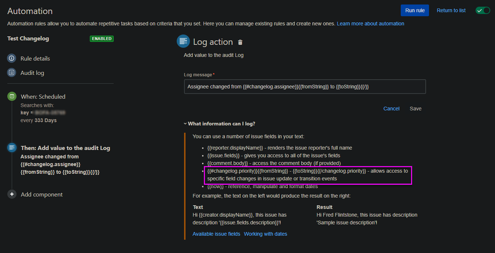

I'm using {{#changelog.[fieldname]}}{{fromString}} to {{toString}}{{/}} to try and search based on automation documentation, but I'm not getting any results.
It seems that you can only access to the smart value "field change" using an update trigger.
One solution could be to use the REST API in Automation
