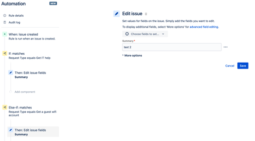

That being said, the best way to set a default text for the summary field based in the request type selected in Jira Cloud would be by using Jira Automation. These would be the steps:

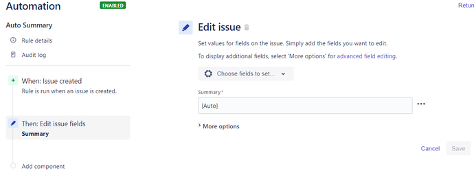

@Petter Gonçalves I've tried your instructions for Jira Cloud and does doesn't seem to resolve what I was hoping to accomplish. When I go to create a new issue it still has a blank required field in the standard Create issue dialogue and clicking create without anything input into the summary results in the "You must specify a summary of the issue." so the Automation never runs.
My hope was to default this create issue Summary to "[Auto]" and if the user overrides it will use the new name otherwise my automation post create would replace the name with fields provided at the time of creation by the user to format a default summary. Ideally, for this type of issue I'm designing, 99% of the time I don't want the user to have to think about entering anything in the to required Summary field.
The automation 'When: Issue Created' seems to only trigger post creation dialogue.
It is also unclear as your steps refer to "Project automation (Not automation)", I only see Automation under the Project settings. I do not see anything that might indicate a difference between Project Automation and Automation.
Am I missing something or is there another way to achieve my goal?
