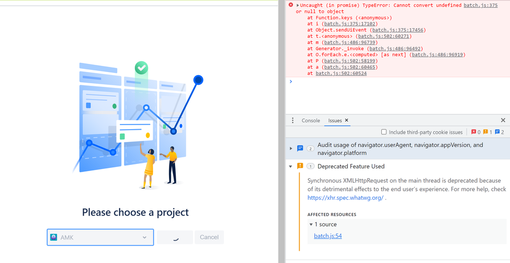

Created a simple manual trigger flow but for some reason can't see the 'Automation' tab/field on the issue detail view to trigger it
I also tried going in the 'Get Started' in the manage apps and tried to 'Automate an existing project' but it keeps loading forever, attached is the console log.
is this some Java issue preventing the app to function properly ?

Thanks for your reply @[deleted], I have done re-installation and no change at all.
Yes I have opened a case with Atlassian and they have confirmed a bug too, so all good!
