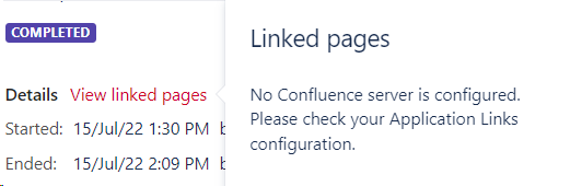

Hi Support,
I'm having issues to log this request as my email (Nivedita.talukdar@flinders.edu.au) account doesn't seem to have authorised yet.
I've attached an email highlighting the issue that we are facing and an looking forward to discuss/explain this further if there are any questions.

Hi Nivi,
This screenshot just indicates to me that the Jira instance is unable to see or reach any linked Confluence instances where such pages would be created.

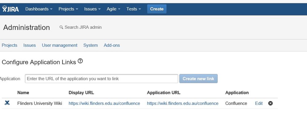

To check this, you would need to be a Jira administration and then navigate to Cog Icon -> Applications -> Application links. You can also browse to:
YourJiraURL/plugins/servlet/applinks/listApplicationLinks
This should show you if you are indeed connected to a Confluence instance and the status of that link. If no links exist here you can then create one with your confluence instance. Steps on how to do this are in Using AppLinks to link to other applications.

Thanks Andy.
Sorry what did you mean by Cog Icon?
With regards to application links, I've attached a screenshot and that confirms its all ok?

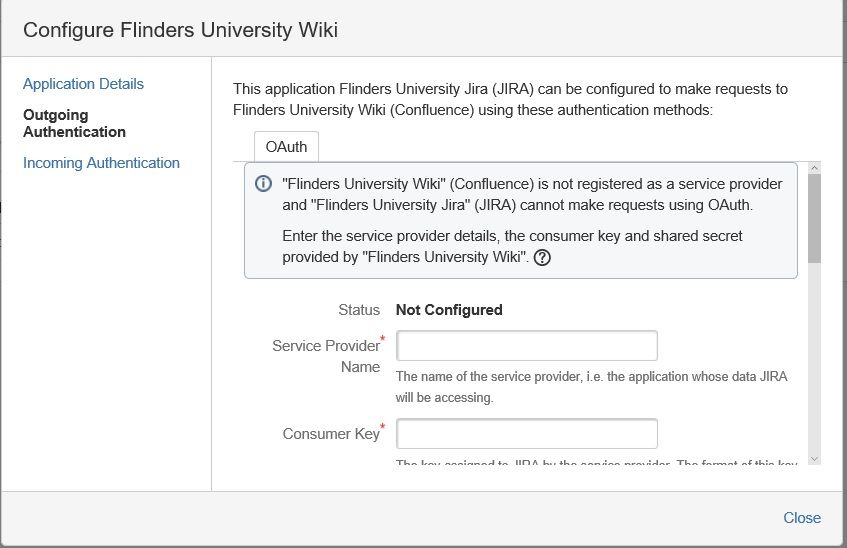

Hi Andy,
I managed to get to Application Links and the Outgoing Authentication isn't configured and I'm guessing if that's the cause of the linked pages not working?

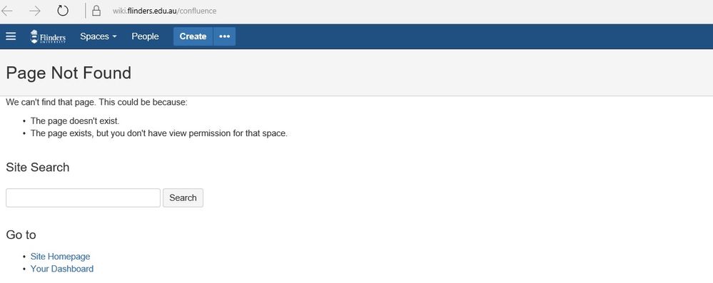

I also noticed that when I click on the display URL, the link is broken and we get 'Page Not Found' errors.
I started the process of creating a new link but couldn't complete it as I didn't have all the necessary information like Public and Consumer key etc

Hi Nivi,
The Cog Icon is in reference to the gear system icon in the top right corner of the page you can see in Jira if you signed in as an Admin.
This lack of setup in your screenshot is pretty clearly the cause of this problem. This tends to happen when you have created the application link in one of these applications, but perhaps your account is not an admin in the other application? If that were the case, it might explain why this application link appears to be only one-way right now rather than a two-way application link. This is explained in the documentation Using Application Links to link to other applications.
Are you an admin in Confluence as well?
Which application link method did you select for this? (OAuth or OAuth with impersonation)?
The difference between these two is dependent upon whether or not Jira and Confluence have the same user base in each application or not.
Before you try to create a new link to the same site/URL, you will probably need to remove the existing link from both sides first. Typically when you link Jira and Confluence, you don't need to manually enter the consumer key. Typically when you establish this application link you are just prompted to authorize it in both applications and provided you can do that, the link can be setup in both directions that way.
