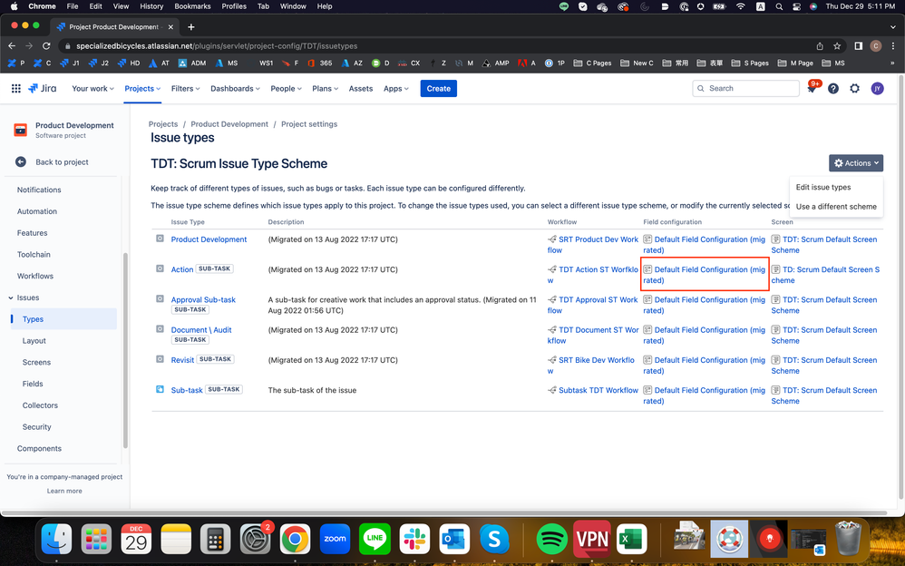

I'd like to change field configuration only for issue type "Action", is there a way to reach it?
I tried to change it from Field Configuration Scheme, Field Configuration for other issues been changed as well.
Jack

Yes, you can change this.
A project has a field configuration scheme, which maps issue types onto field configurations separately.
The field configuration scheme that the project you are showing us is using is a simple one; it maps the same (default) configuration onto all the issues.  (I would hazard a guess that it's the default field configuration scheme)
Go to Admin -> Field Configurations, and add a new one, or copy an existing one, and give it a good descriptive name.  Then, go to the field configuration scheme that your project is using and change the mapping for the issue types you want a different field configuration for.
