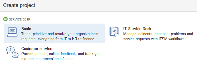

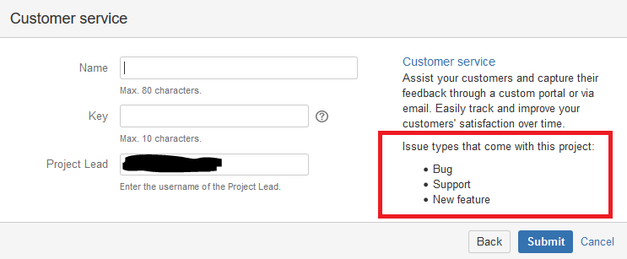

I have created own request types for our service desk. I deleted the others because we do not use them. But everytime I create a new project it creates the standard request types again and allocates them to the project.
Is there a possibility to change the default request types for creating a new project? Or maybe create an own project type "variant", e.g. Service Desk comes with Basic, Customer service or IT Service Desk (see also attached screenshots). Can I create an own one?

The project creation templates are not configurable that way.  They're actually small add-ons that tell Jira how to build a project.
To change the issue types they try to create, you'd have to hack those add-ons (or, better, copy them, and adjust them to make your own versions, then disable the system ones)
