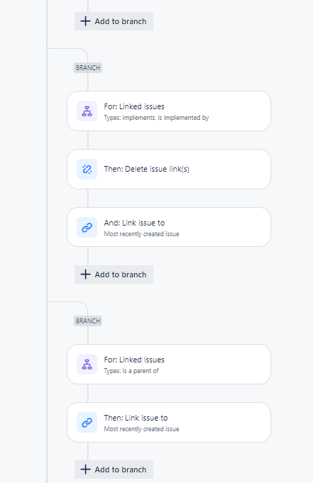

Ivan Guillermo Seligmann June 14, 2024
Hi @Bill Sheboy
Thanks so much for your answers, the issue is solved not and your comments were very helpful!
I ended changing the automation, and some Branches gave me the exact result I was looking for, though I have to do it in 100 issues chunks, it still works
An additional problem was related to some project configuration, apparently, even when I had linked issues, some "linked issues fields" were not present in the project, our internal support team managed to fix that
In case it could be helpful for someone else, I am including here the final version of the automation
have a nice weekend!
