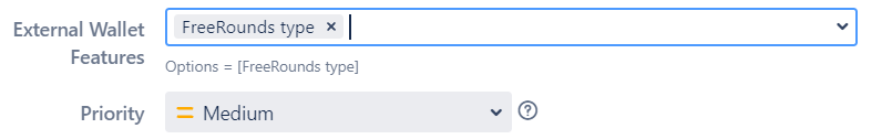

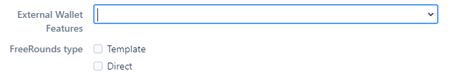

What it does, is that if I only select "FreeRounds type" option in my multi-select it works fine and the field of the same name appears:

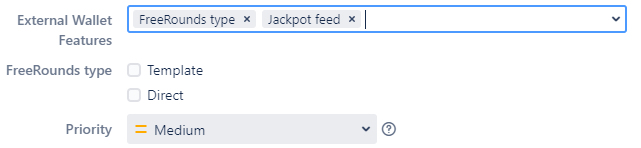

However as soon as I add another option to this multi-select, the field "FreeRounds type" disappears:

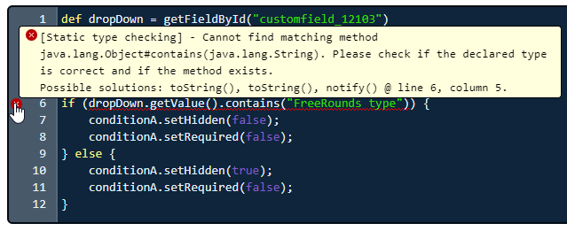

I found that changing == to .contains would work so I changed the line 6 to:
if (dropDown.getValue().contains("FreeRounds type")) {
but that returns an error:
and the Behaviour loses its functionality entirely. The field is never hidden:

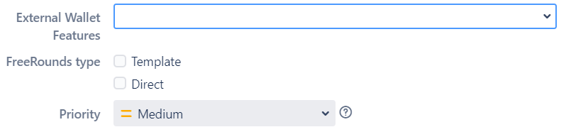

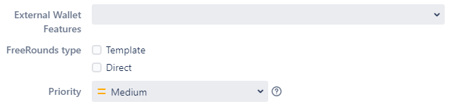

Sadly even after adding the bracket, this still doesn't work properly. Funny, because what happens now is that halfway it somehow works backwards. Meaning that FreeRounds type field isn't hidden until the option "FreeRounds type" is selected.
Option not selected, filed not hidden:

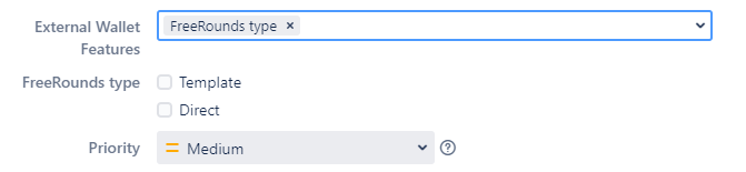

Field hidden when option selected:

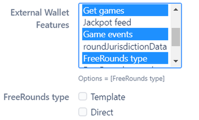

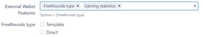

However, selecting multiple options containing "FreeRounds type", it works again:
To sum up, this works only halfway. Can we somehow get it to work in both cases? That is in working case of selecting multiple options, including "FreeRounds type" as well as in the event that only "FreeRounds type" is selected?

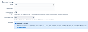

The reason why it does not work when the page first loads is that you need to ensure that this script is triggered by adding it to the Initialiser section of the behaviour, along with the same script in the field section.

Hey, @Alex thanks again for your help.
I've added the script as an initializer too but it didn't change anything. The field FreeRounds type is shown as the page loads and disappears when "FreeRounds type" option is selected as a single option in External Wallet Features field. It of course reappears again when there are other options selected in the field.

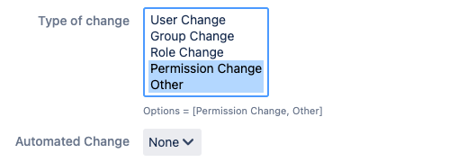

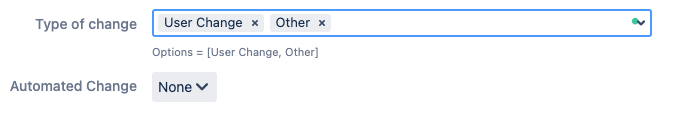

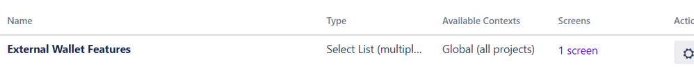

One difference that I noticed is that the field that I am using Type of Change is a Select List (multiple choice), as you can see below:
The field Automated Change appears only if Other is selected regardless if any other option is selected or not.
Can you review what custom field type is the customfield_12103 ? Also, if you employ the content of whatever variable you'd like to test to the description of the field, it's easier to figure out the content stored in that field.

I concur that the customfield_12103 is a Select List (multiple choice)
And yes, your example is exactly what I'm trying to achieve.

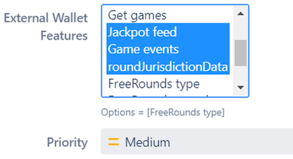

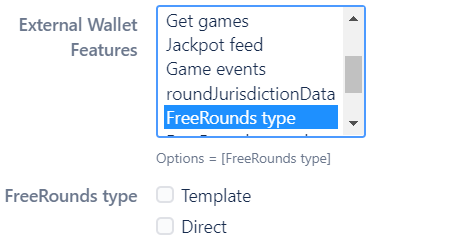

I added the description in both, the initializer and in the field as follows and it appears in the description.
//customfield_12103 = multi-select
//customfield_12100 = checkbox field
//I want the checkbox field to apear only if the multi-select field contains "FreeRounds type" option.
def dropDown = getFieldById("customfield_12103")
def conditionA = getFieldById("customfield_12100")
dropDown.setDescription("Options = " + "[FreeRounds type]")
log.debug("dropdown value" + dropDown.getValue())
String[] options = dropDown.getValue() as String[]
if (options.contains("FreeRounds type")) {
conditionA.setHidden(false);
conditionA.setRequired(false);
} else {
conditionA.setHidden(true);
The functionality stays the same.
1. The field is visible and there is no description.
2. When the option is selected, the field disappears, which it shouldn't, and the description appears.
3. Selecting multiple options, makes the field visible again, and the description remains there.
I'm not sure where I could begin to look for the issue. It would be helpful if you could point me to the issue.

Here is the code in action, working as expected:
1. No option selected, field is hidden
2. "FreeRounds type" option selected, the field appears
3. Selecting multiple options including FreeRunds type, the field appears
4. Selecting any other option except FreeRounds type, the field stays hidden.

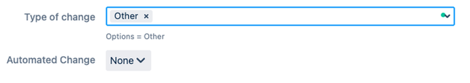

I am still using the description trick I mentioned before. See how Jira stores the information when 1 option is selected:
And now, when 2 or more options are selected:
I managed to get around this by changing how the options list stores the values:
