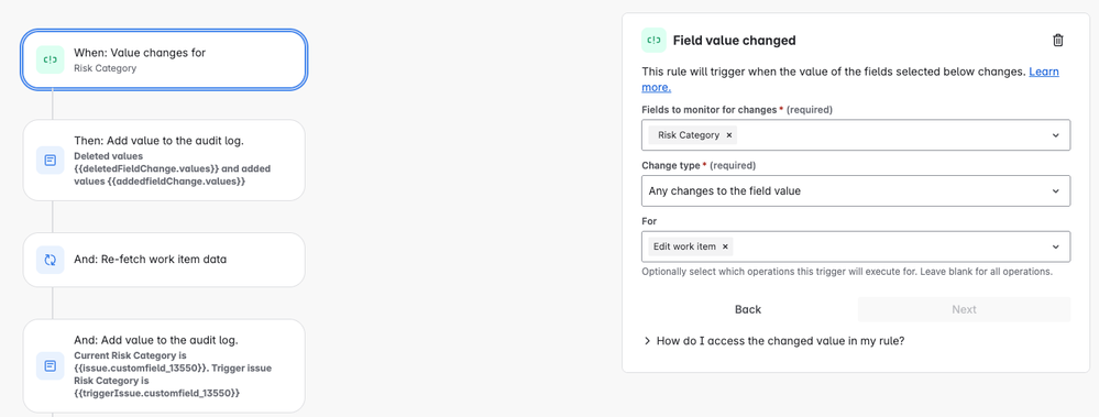

In Jira Cloud, company managed project, I'm trying to update a custom field ("Field A") in a child issue when the parent issue is updated.  The custom field is in both issues, and the automation says it's successful.  However, the child issue doesn't actually change.  Screenshots below.  This is the beginning of the rule (I know I don't need both values in the second audit log; that was more for me to make sure I had the trigger Issue straight in my head):
The second part of the automation

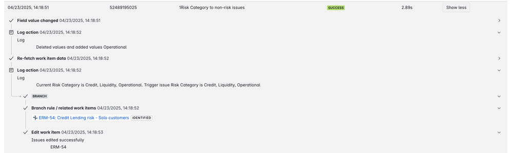

This is the result in the audit log when I change the Risk Category
The "Risk Category" field in both issues is the same (custom field 13550), but the destination issue shows no value at all.  Please help, I've been working on this for days!

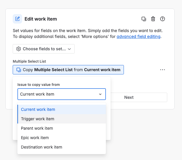

Screenshot 2025-04-23 at 8.15.04 AM.pngScreenshot 2025-04-23 at 8.15.16 AM.png

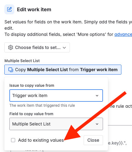

Next, when copying data from a multiple selection list there is an extra option in the dialog. Do you have this box checked or unchecked?
Based on my testing with a Company Managed Software project, with the scope of the rule set to that one project and both the source and destination issue in that one project, when that box is not checked, then the linked issue will be updated to match exactly the multiple selections in the trigger issue, whether values are added or deleted from the multiple selections.
