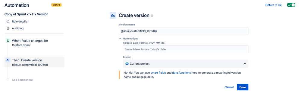

So to accomplish this I have set up an automation to edit the Fix version field values anytime the custom dropdown is updated. However, I am running into issues when multiple values are selected. My current setup, which doesn't work for multiple values, is this:
This works as expected when a single value is selected in the "Custom Sprint" multi-select field. However, when two or more fields are selected, I get the following issue:
Instead of creating two separate versions, it creates one with the two field names together. This makes sense because of the value, {{issue.customefield_10050}}, I have in the automation rule. I can't seem to figure out how to separate the multiple fields to represent different values. I am thinking it may have to use some of the #changelog functionality. Any ideas or suggestions would be awesome! Thanks in advance.

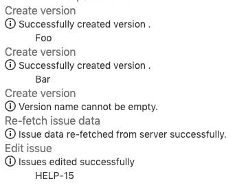

Also, I was a little worried about what might happen if you try to set a version to an empty value. But Automation appears to do the right thing, and continues trucking along:
Your log files will show an error, but I don't think it's severe enough to generate a notification.
