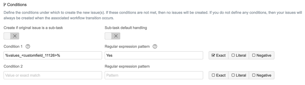

I'm pretty sure I have my syntax wrong, any help would be appreciated.
I have a custom field; Select list / single choice (Yes/No). When an issue is created, I need a sub-task to be created if the custom field value is equal to 'Yes'. I have tried a variation of the below, but I don't think I have the syntax correct. If I remove the condition, the transition works correctly.
Condition 1, %values_<customfield_11126>%
RegEx, 'Yes' (exact)

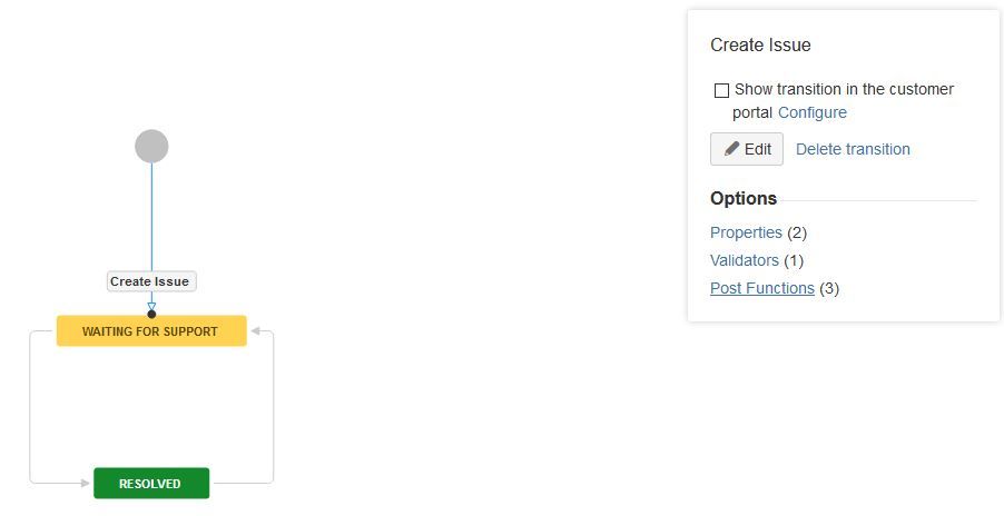

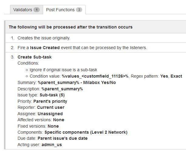

HI Fadoua,
Thanks for your article, you are covering what I am trying to accomplish. The only difference is the condition being with a custom field. This is a very basic workflow, only testing the POC right now. I believe the steps are correct, it works without the condition. I just believe my syntax is not correct. See screenshots below:
Workflow Diagram:Condition on 'Create Issue'

It looks like I was over-complicating the syntax. The condition worked correctly when using it without < > characters. I also removed the mention of the 'values' data.
ie. %customfield_11126%
