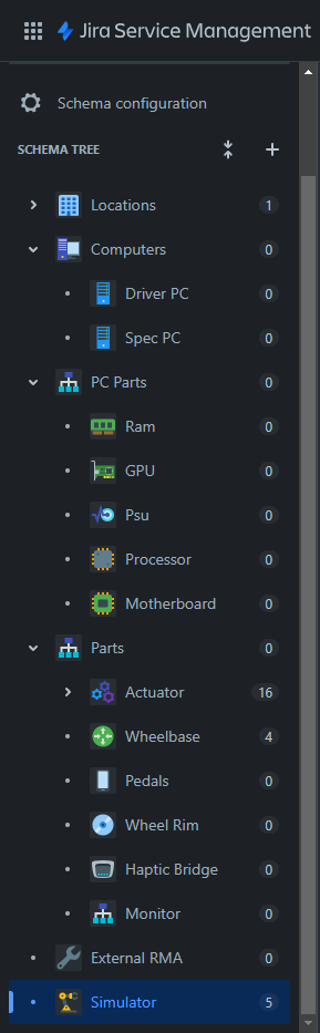

I'm just trailing Jira to create a helpdesk and also an Asset system.
I'm trying to create a custom field for a form which would allow users to return a part to us.
I want a dropdown which will list the Object type rather than an object itself. In my case I would like to filter PC parts and then for them to be able to select whether its ram, gpu, psu etc and then the next field would show only the objects within that type.
Have tried lots of different combos of AQL but cant seem to find how to do it - Any advice? I'm very new to this so as well have included a rough draft of what my tree looks like. I could well be thinking about this the wrong way.

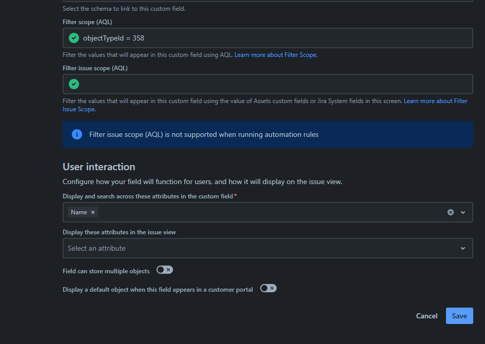

I would probably create a new object type called "Part Type" then assign that as a reference to parts that way you would be able to select the part type first, then use that data as a reference in the second lookup.
Lets say that Part Type has objecttypeid 777
For your parts you would create a reference to Part Type.
First field - Part Type
Field ID: 10999
Lookup: Filter scope (AQL): objectTypeId = 777
Second field - Part
Filter scope (AQL): objectTypeID in(333,444,555 etc)
Filter issue scope (AQL): object HAVING outboundReferences("Name" = ${customfield_10999.label})
It does not really need to be a reference within assets, you could have data from a choice field i believe, however connecting the data with assets secures any future changes you may do.

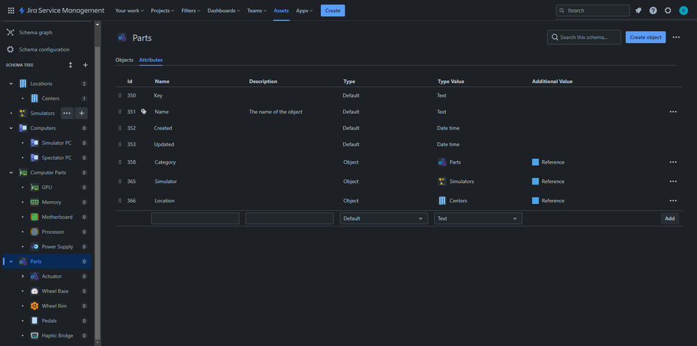

Hi thanks for the answer.
I'm still struggling.
I have set an attribute on the "parts" Object type and selected "parts" as a reference - and then this is inherited to all the children.
When i run the form the field just comes up as blank.... Is this what you meant. Apologies, feel like i'm fumbling around in the dark a bit here.

What you are doing now looks to be that you have created a reference to parts so basically if you had a specific Wheel Rim then you could reference that to a specific Wheel Base so you could easily find matching equipment. So not what you were asking for.
Create a new objectype that is called "Part Type" it only needs to have a name as attribute at this time but you could build upon it later on.
In Part Type create an object for each part type, i.e. Wheel Base, Wheel Rim etc.
In your original objecttypes for Parts then add the new reference to "Part Type" and set Part Type to all objects.
