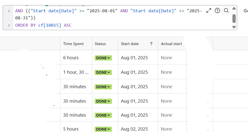

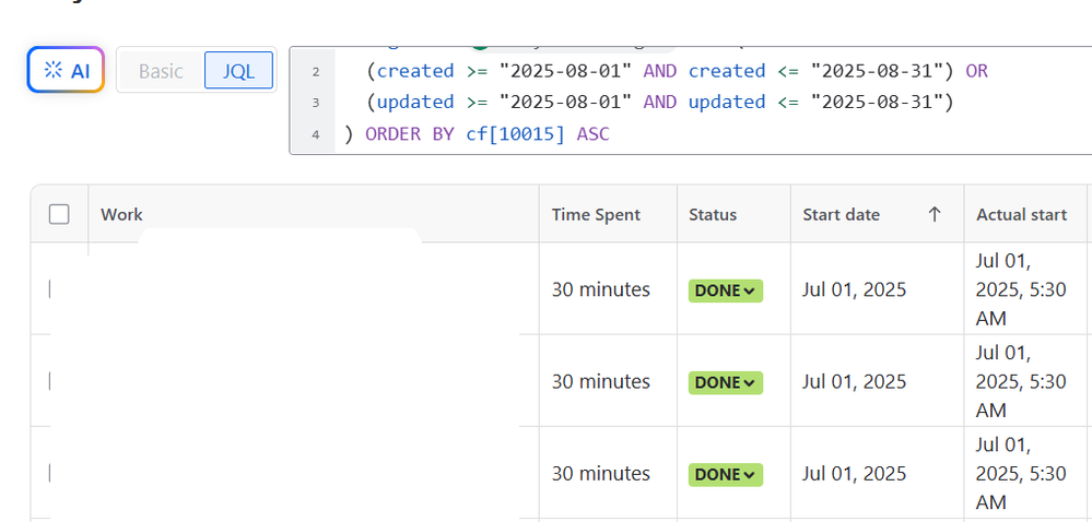

Tuncay Senturk _Snapbytes_
August 13, 2025
Is this "Start date" that we see on the screenshot the cf[10015]? If yes, these rows indicate that they are July 01, so we don't expect them to be between 2025-08-01 and 2025-08-31. My second question, are you sure that it's a Date field?

Sorry, my mistake refer the recent screenshot
2nd Question - Start date
August 14, 2025
Great, I see that using the start date in the JQL returns results as expected. So, do you mean that JQL runs OK in the issue navigator but it doesn't work via the Python script?

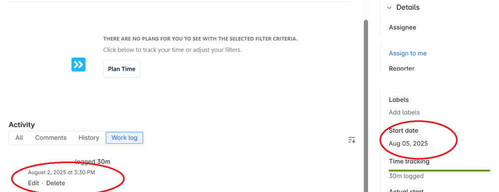

One more confusion below, for example if the team member Add the start date as 4th August and in the work logged it is mentioned as 14th August so it is misleading the entry is added for 14th August but code is written for bifurcating with Start date
If you check the above sample sheet all task are logged for todays date ?

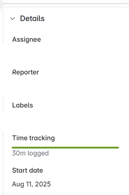

Please do reply on my 2nd Question. What if the team member by mistakely add Date Started in Time tracking as "2nd August" as shown in worklog and Start date is 5th Aug but it still shows the task start date as 2nd August in python script? How to avoid this?
August 14, 2025
I see! That really depends on how you’d like to handle it.
You could filter issues by Start date and exclude any work logs that fall outside the range (you’d need to add an if statement in your script for this), or you could filter issues by worklogDate directly in your JQL.
Keep in mind that an issue can have multiple work logs, and some may fall outside the target range (e.g., 1st to 31st August). For that reason, I believe it’s better to filter out the work logs in your Python script.
