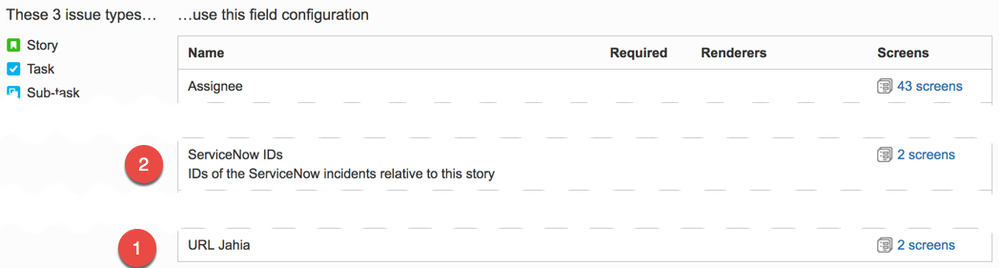

I just checked that both fields are associated with the same issue types:
They appear on the same screens:

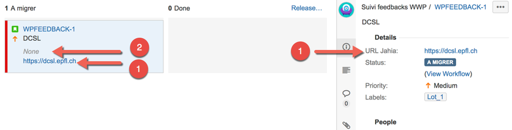

They show up on the board, but the second one does not show up on the details pane:

When there is not value for custom field it is not showed at view screen.
I see that on Kanban there is "None" instead value.
