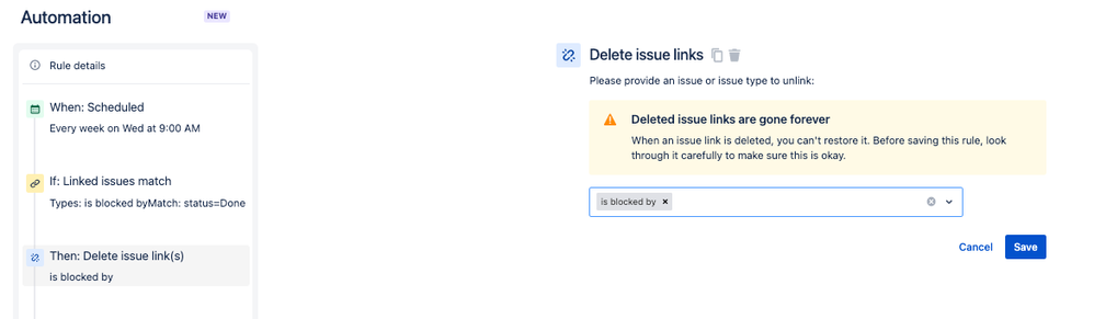

The next component in the rule would be actually be a Condition for Related Issues rather than a Lookup Action.
This condition will check that all issues linked to the primary issue (retrieved by the schedule trigger) with the "is blocked by" link are in a Done status. If they are, then the next step will execute. If they are not, or if there are no linked issues with that link type, then the next step will not execute and the rule will iterate to the next issue in the list retrieved by the schedule trigger.
The next step would be a Delete Links action to delete the l"is blocked by" issue links.

Hey @Trudy Claspill ,
that works very well. Thank you for your support :-)
