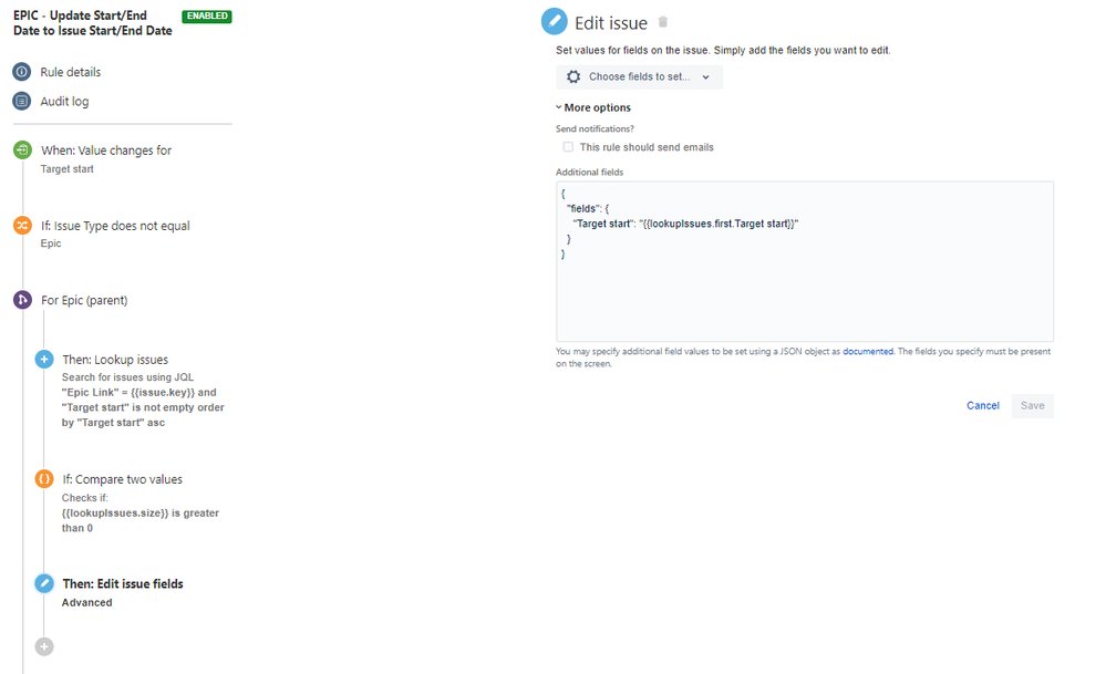

I am nearly there in getting it to work in my environment. The only problem is I am on the Jira Data Center version and the field "Start Date" is not available as an option in the edit issue dropdown. It appears the workaround for this is to write it in JSON. So I have written the last step to Trudy's answer as follows under edit issue->additional fields:
"fields": {
"Target start": "{{lookupIssues.first.Target start}}"

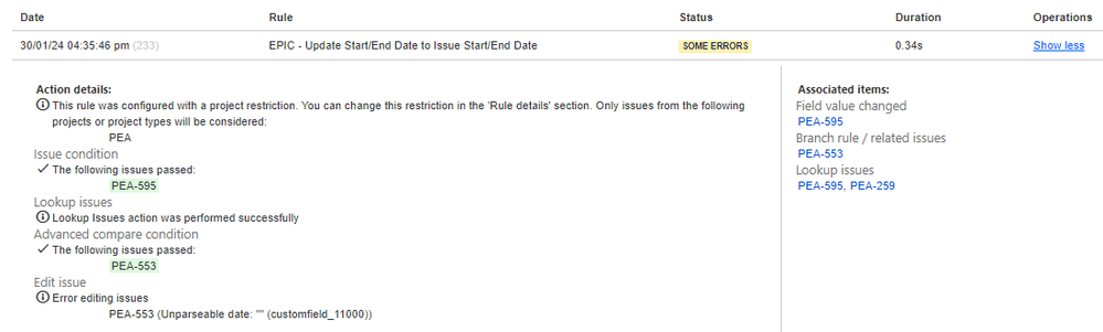

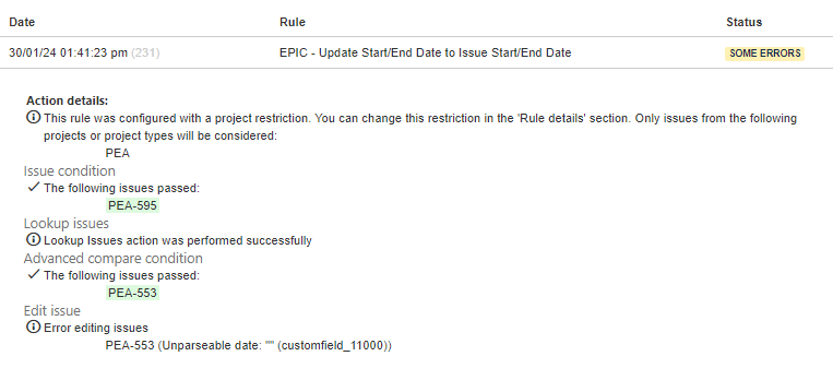

Unfortunately when the rule is run, it errors out with an error that reads:
ABC-553 (Unparseable date: "" (customfield_11000))

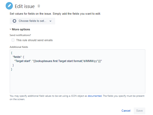

Thanks for the reply, @Bill Sheboy . I did, I should have mentioned that in the post. This is how I did it. Did I setup the smart value correctly?

Next, if the field is present, I do not know the format / field type of Target start with Jira Server.  Some of the Jira fields indicate "date picker" in the admin functions, but they are available to rules as text.  In that case, try first converting to a date, then adding the format:
{{lookupIssues.first.Target start.toDate.format("d/MMM/yy")}}
The final possibility is if the nested double quotation marks are causing the problem: one for the JSON and one for the format() function.  To solve that, a created variable could be used to first format the date.

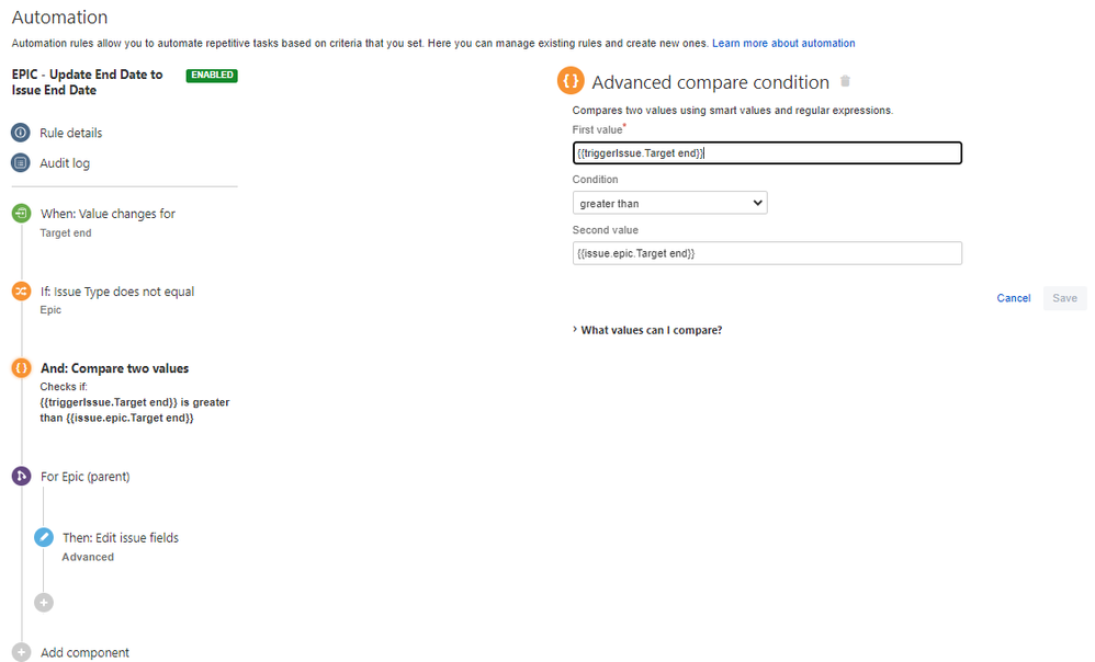

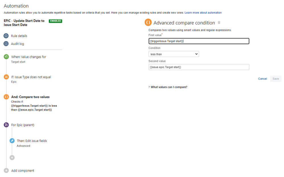

I am going to look into this with my Jira admin. In the meantime, I think I have created a temporary solution. It is not as good as the original solution, however. This required two rules that runs checks against the trigger issue when the sprint value changes. It then does comparisons of the trigger issues target start and end dates and then updates the related epics target start and end dates if the advanced compare condition is met.
