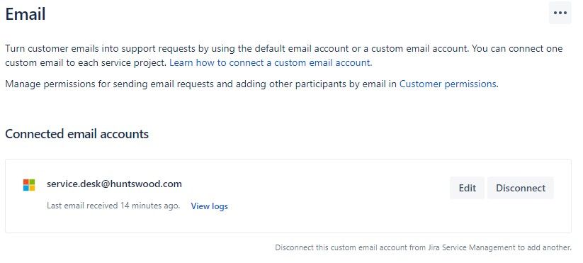

We are using an Outlook tool precompiled by Trend to allow our users to send an email to service.desk@huntswood.com. The email sends out as the Outlook user and creates a Jira ticket.
In the Jira service desk project we have setup email requests using this same email as per attached screenshot.

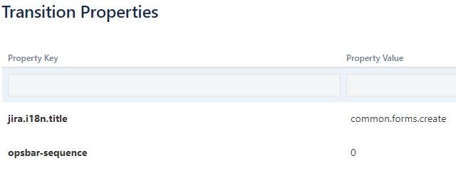

Since you are seeing a difference based on the workflow that is managing the issue creation, you should probably examine the Create transition in that workflow to see if any Post Functions have been added that might be removing the attachments. You might also look at the Automations associated with the project (or globally) that could be impacting the state of the created issues.
Hi Trudy
I checked and the only difference I can see is that SD: Service Requests workflow has create transition properties as attached and the SD: Incidents workflow does not have anything defined.
