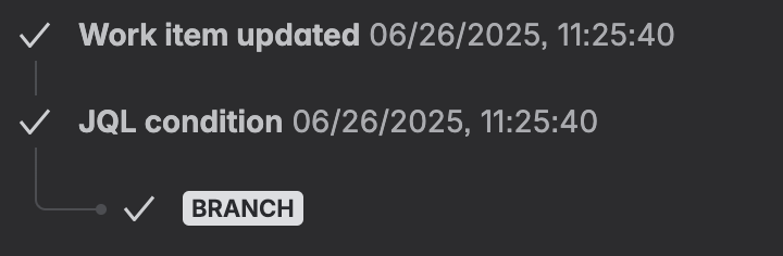

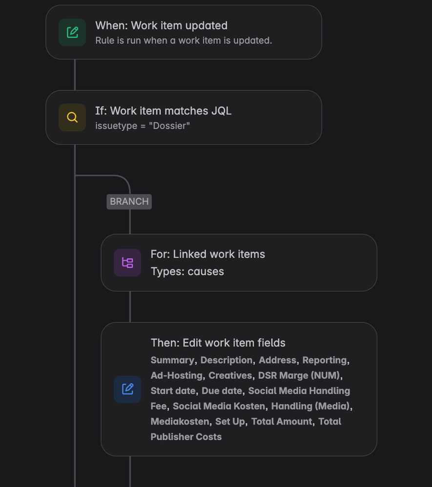

Problem is, Work Item Updated actually includes the status update transition.
It does not show it explicitly, the audit log just shows that the condition has been triggered. But we know through trial and error that the only thing changed was the status.Screenshot 2025-06-30 at 18.18.56.pngScreenshot 2025-06-30 at 18.12.53.png

How are you updating the status of the work item such that it triggers the rule?
When I tested with a manual status transition (i.e., direct field edit or drag-and-drop on the board) the status transition does not trigger Work Item Updated...
However, with a drag-and-drop change on a non-empty board, the Rank field often updates, and that will trigger the rule.  This can be confirmed by writing the entire {{changelog}} smart value to the audit log.  And, that is a different event than the transition itself.
