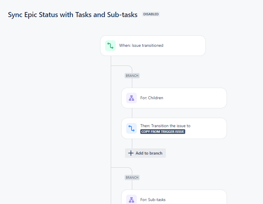

I want to create an automation to move status following the parent status. In the board there are 3 types of issue Epic, Task, and Sub-Task. I already create rule like iamge below. But it does not work well.
Hi @Thomas A
If your rule detects an Epic transition and then transitions child issues (e.g., Story, Task, etc.) and grandchild (e.g. Subtasks) to match, why have any child or grandchild issues? It would seem they are not used to track work items / progress.
Often this type of scenario is inverted: when the first child (or grandchild) transitions to in-progress, move the parent as well. Similarly, when the last child (or grandchild) transitions to done, move the parent to match.
Bill
There are two approaches to to manage the service limit, counting impact when cascading changes through multiple issue levels in the hierarchy:
Using multiple rules, where there are separate rules for each hierarchy pair and use conditions to manage that:
Use one rule, which uses Lookup Issues to first gather all of the issue keys needed, and then uses a JQL branch to iterate over them in one pass. For this approach, the allow rule trigger option is not needed.
Hi @Thomas A ,
your automation rule is correct. Problem is rule is not executing again. Try enabling following option in Rule Details.
Go to Rule -> Rule Details -> Enable following option
Cheers!
We need to enable that to move sub tasks. Because, First it will trigger only child task, then again we need to execute the same task to trigger subtasks. If its correct please mark the answer as correct
Cheers!
Using the option to allow rule trigger may not be a good approach for this scenario.
The reason is a self-triggering rule for three levels of issue hierarchy could quickly trigger more than 10 times and halt rule execution due to service limits for loop detection: https://support.atlassian.com/cloud-automation/docs/automation-service-limits/
Bill
