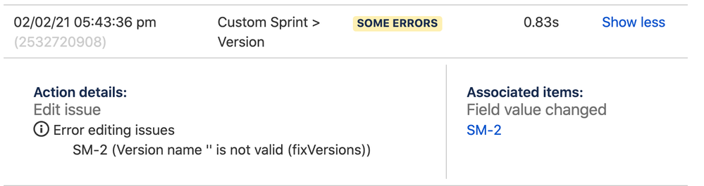

When trying to connect a custom multiselect dropdown field to the Fix version field via automation, I receive an error:
The Fix versions and the multiselect dropdown fields have the same values and are apart of the same project which is odd. I was able to automate these fields together when using a single field but needed to change the automation code to account for multi selections.

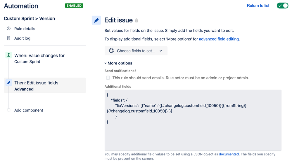

Here is a screenshot of my automation set up:
Any idea what the issue might be here? Thanks for any help in advance! šš¼
So, a couple of things.
1. If somebody selects multiple versions, this will probably break, because you'd potentially be trying to set the field to:
[{"name":"5.1","5.2","5.3"}]2. I don't think you need the full {{/changelog.customfield_10050}}. {{/}} should do.

When entering your code above, then attempting to publish changes, I got the following error:
Error while parsing additional fields - Failed to close 'changelog.customfield_10050' tagI think it has something to do with:
{{^last}} , {{/}}When I removed the {{^last}} , it seemed to get rid of the error but still no dice with the automation.
